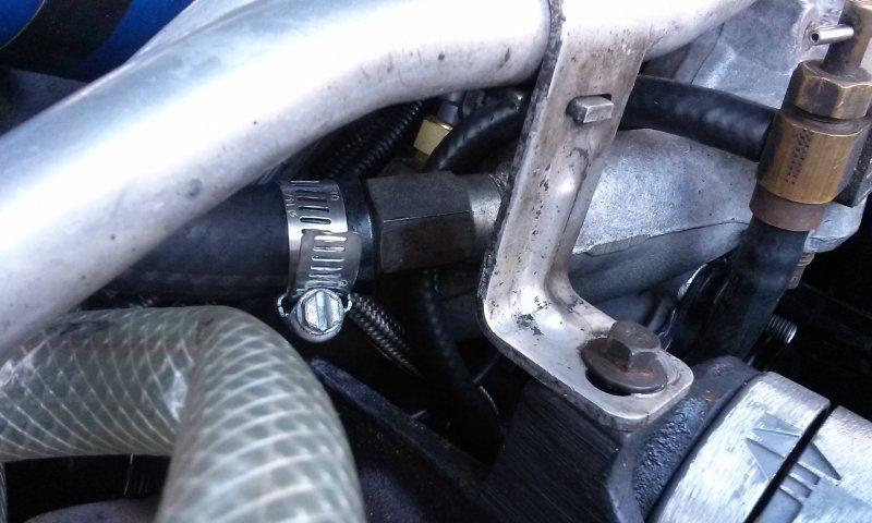

Does anybody have the part numbers for what I need to reinstall the line into the thermostat housing?
When I pushed the clips and pulled the line, I got a lot of little rubber pieces. I tried searching some schematics but could not really see what I needed
I came up with GM part numbers for the line and the fitting that go to the dual thermostat housing.
I am not sure what is needed for seals. It's been forever and a day since I had this apart.
http://parts.nalleygmc.com/showAssembly.aspx?ukey_product=2814358&ukey_assembly=369992
Line and plastic piece #3 & 4 one part number 15998367
Fitting to the thermostat housing #5 15650056
There was a lot of black rubber that came out of the fitting when we took it apart. I do not know if this was pieces of seal or if it was ultra black from the water pump install.
I am not sure what I need to reinstall things and not have any leaks.

That looks like it will keep the quick-release connector in the system which is also known for leaking.
Here is a post that talks about making the misc parts much more durable: http://www.thetruckstop.us/forum/threads/help-need-t-connector-options.37644/#post-43040
