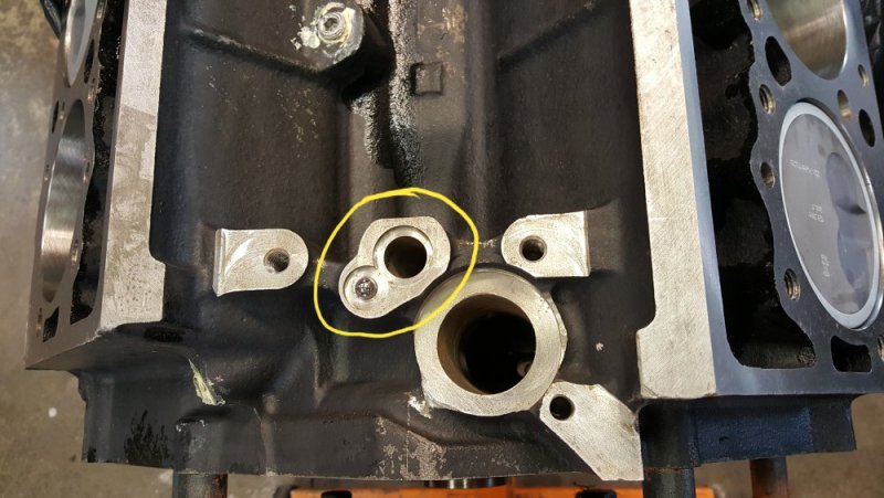

Imo, You should also post pic of how they “sealed” the oil supply to the center mount turbo here for people to see.
And so a plate needs to be made to plug this hole ? Oh wait, the small hole with the messed up plug looking device must be for the oil supply, large hole for oil return.
Yes, that is correct. the seal is a 1 piece rubber oring. the bottom of the turbo that mounts there is surfaced flat. so just the oring seals the pressure side apart from the drain side all the time. The bearing seal was not needed.
