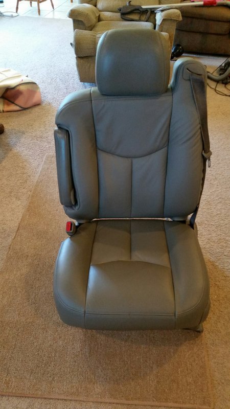

I just finished my drivers seat. Bought the lower from a Shop in Houston, TX and the Back part from the dealer
Tim _ is it just the picture that shows a color mismatch? The installation looks great.
It is the picture, I took the bottom cover to the dealer and let the parts manager look at it. He was amazed that it looked like factory and was 200 bucks cheaper. The top was purchased by the dealer at cost plus 6 bucks. So they only made 6 bucks on it. My dealer really treats me very well.
