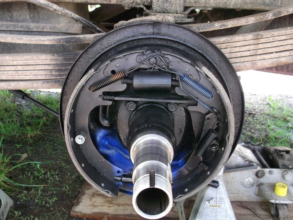

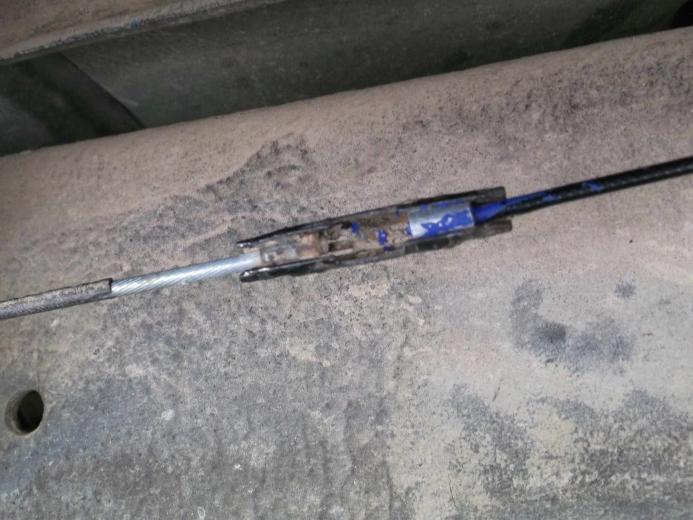

OK Guys, we are near the end of this issue, I have learned a lot about parking brakes that I did not actually wish to know! ;-) such as There is no adjustment for the force applied to the rear shoes, totally controlled by the length of the cables, and my 155" wheelbase requires 83 7/16' cable for the left rear drum. The AC Delco one I ended with was 1/8" short of that but it works Fine. The cable is for a crew cab and a cab and chassis (which mine is).
I adjusted the equalizer so when the parking brake is 'on' there is no slack in the cable... but the left side will lock up the drum and slide the tires in the gravel when the parking brake is lightly applied. The right side will not slide the tire ? Is this normal I can not get it to slide no matter what I do with the eq. adjustment.
I posted some pix of the final assembly.
