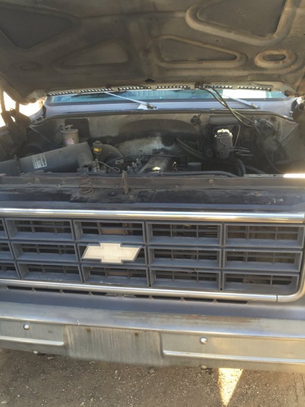

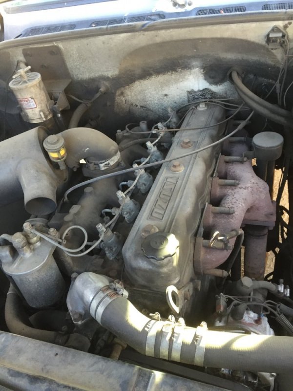

The talk shifted to trucks and cars. He has a Ford Model A in the back barn. But the most interesting thing he showed me was a 36 year old Chevy 1 ton, single wheel with a 190 hp 6 cylinder Isuzu diesel conversion that he did. He said "you can't kill this engine." It's naturally aspirated and there's tons of room in the engine compartment. Changing injectors would be a breeze.

I remeber wrenching on one or two of those engines. Easy to do the maintence, and he is right they chug along for ever.
Sitting in the there it reminds me of the 230/250cid gasser in the 70's pickups.
we have the turboed version in a 79 C30.
Previous owner converted it from 454/ Turbo 400 2wd to body lifted Isuzu I6 turbo, Isuzu 5 speed, random 3 speed auxillary (filed slots in driveline flange and clamped it with bolts and flatwashers) Everything the guy did sucked. It works, but he cobbled it bad.
The reason its parked is the auxillary is failing. My plan is delete it, and swap to 3.42 gears and run just the 5 speed. looks kinda dorky with the body lifted dually bed, so I want to put a flatbed on.
