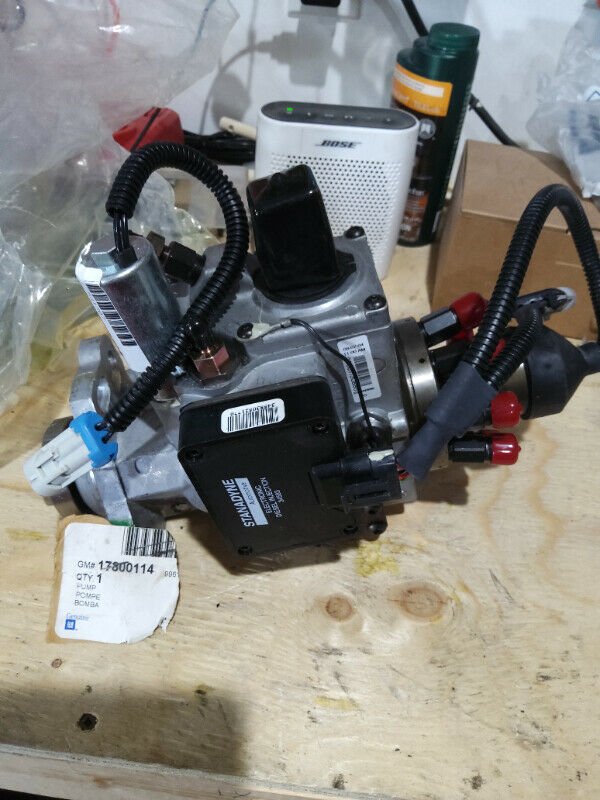

If you know for sure you will use them both and not jump ship to different truck later, or could get your money back out of both after buying then paying to upgrade to -S parts, yup do them now and store them or run one now and store the other.
As to storing an ip that bas been used- ideally I would say flush out the diesel fuel with a straight 10 wt oil. We know what happens to fuel with ethanol or methanol in it and it sits in carburetors for a while. Seals dont do well, jets get plugged, etc. Same thing is gonna happen in the ip. Now, in the case of these two- it has already sat for that long so don’t change it now, any damage has already happened if it is going to happen. If you are just going to store it as is- then seal it up from outside corrosion and your done.
If you are going to pay for them to be gone through now- then do it and leave the testing fluid from the bench in it and seal them up.

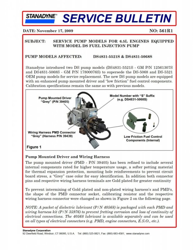

You probably heard me saw 100 times loose the ds4 and go db2. But right now your tight $ situation- don’t do anything not required. The possibility of buying a ds4 and pmds is huge part of the issue. Now that a guy can buy 1 lifetime warranty pmd, which I think you already did, and you have a known good spare ds4- stick with it until you loose the existing ds4 on the truck. If you can gather the other throttle pedal, cable, other parts for free for conversion- start gathering them, But don’t spend the $.
I wouldn’t buy a used db2- and who knows the condition of any used one. Obviously free and known good like the ds4 is ok. But you still need to control the transmission and that costs $$$.
Honestly you don’t know if 10,000 miles from now the crank snaps- so don’t spend on unknown until your income is solid again. A db2 is not going to save you money at this point, so bad investment. You could sell the pmds, app throttle, ds4s, yes but probably not enough to break even so I say run what ya have for now.
