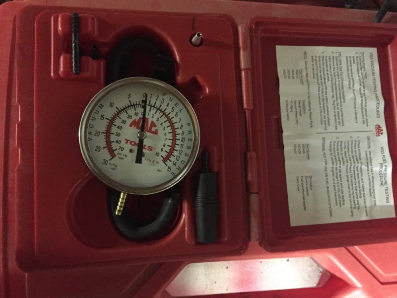

For just the fuel pressure, make sure it has a vacuum gauge also. Harbor freight sells a basic one for like $30. My preference is this Mac:

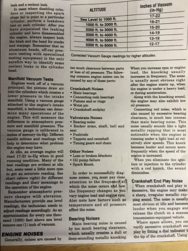

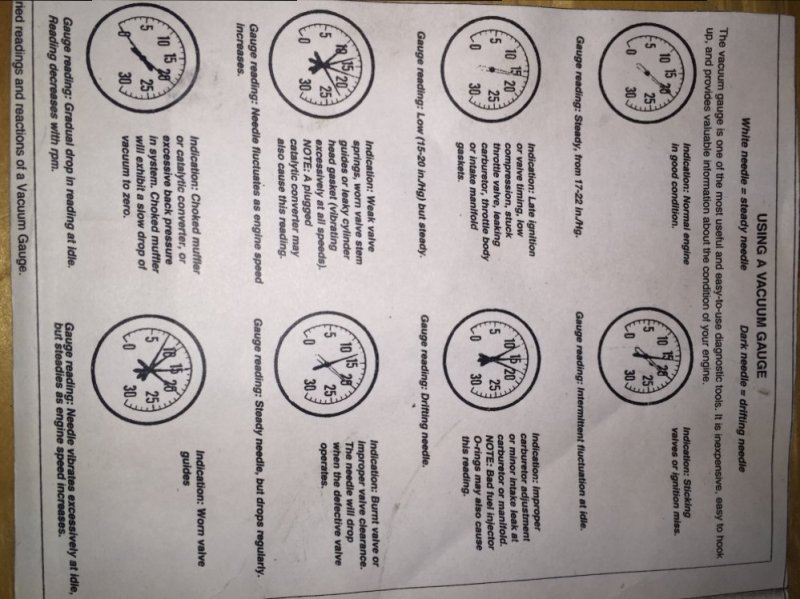

While I'm next to it, here's a cheat sheet I keep with my test gauge incase it helps someone on other stuff besides fuel. Keep in mind the little description and spec is for non boosted gas engines, but kill your turbo and valve tests, and such still work-just not as dramatic changes.
