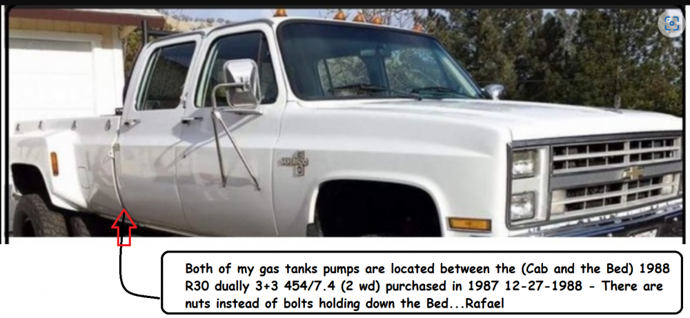

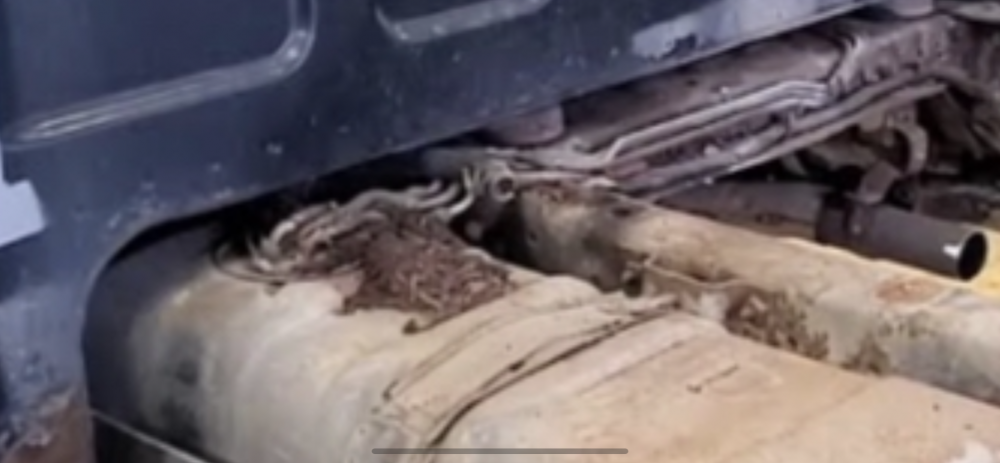

On my 1988 Chevy Silverado R30 454 / 7.4 Crew Cab Dually, I find nuts at eight location that seems to attach the bed to the frame. Every YouTube video shows bolts. In addition, my two gas tank fuel pumps merge at the location of the cab and bed. If I remove the bed, will I be able to pull out the fuel pumps from the gas tanks. (is there enough clearance?) Is there anything else that needs to be removed other that the two gas filler? Thank you in advance for your assistance to either giving me the specs on where the bed attaches to the frame or anything else that I should know. Rafael

Consider dropping the tanks instead.
The straps that hang them are easily replaced if damaged.
If you haven’t already- replace the rubber fuel line with sae30r9. This is the kind that withstands ethanol/methanol in all modern fuels.
With the tanks out you can inspect and clean the tanks - not really an option while in the truck. Far less hardware to remove, lowering with floor jack isn’t bad.
Just siphon out the fuel first to make it all easy.
If rust is any issue- figure what is easiest to deal with. Tank straps and hose clamps are easy. 8 bed bolts not so much.
Thank you for the quick reply... Don't you think that if I left the tanks in place and siphon out the gas, I can clean out the tank before installing the two new Dephi HP10256 and HP1-255 fuel pumps... I thought to only tilt the bed from the cab side to gain access to the fuel tanks. Then I won't have to left the truck other than a jack to lift the tank side of the bed... Your thoughts. Rafael
If you do it that way your fender flares are going to hit the tires(depending on what size rubber you have) on the other side before you get it high enough to pull the pumps i would think. You would still have to at least loosen the bolts on passenger side and unplug tail light wires.

Will's right, on the square body trucks, the pumps are partially under the cab. for the 1500+ series newer body style they are accessible by lifting the bed. ether way on these older rigs, your almost going to have to torch off a couple of bolts holding the bed on the frame due to rust and years of dirt under there.
dropping the tanks isn't that bad, just a dirty job. tanks are mounted outside the frame and you don't have to loosen the straps to pull the tank. the straps are attached to a bracket which has 4 bolts on the frame. the hardest part is getting to the fuel lines above as it's a tight area to get your hands into and have to feel around vs seeing what your doing.

Thanks to all of you for the great suggestions... I still have not made a decision yet... If I take to someone, they may not clean the tanks like I want it... Hopefully I will find a location to do the work myself... I am not allowed to work on my truck where it is parked. Rafael
Purchased on 12-27-1987 - sorry for the typo. Rafael
