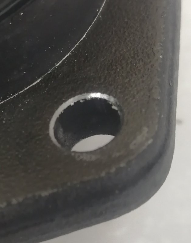

Got upper ball joints with ebay. With holes 5/16. But I need 3/8. I decided to drill.

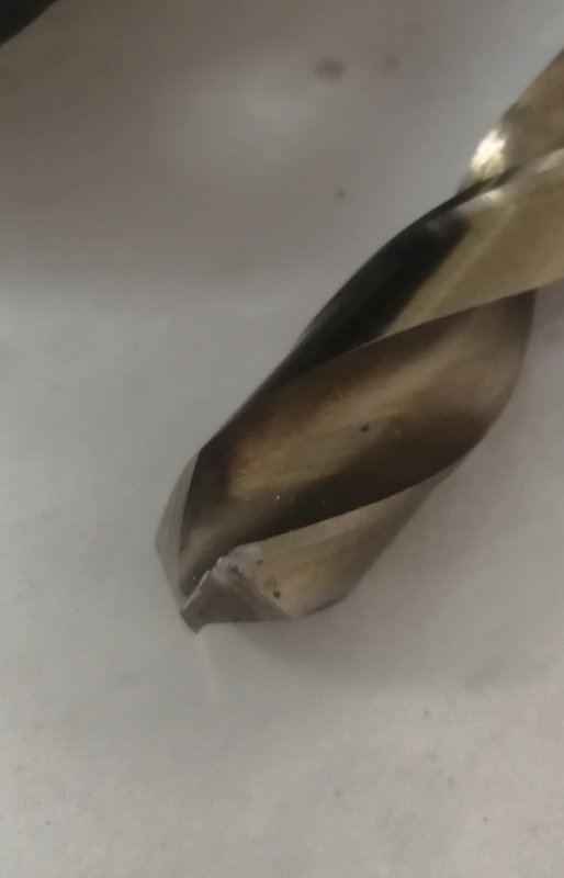

I could not drill anything. Some kind of super durable case. Used 5 new cobalt drill. Drills checked with a metal analyzer "Oxford XMET8000"
Drills from steel R6M5K5 ( T11341). The analyzer did not determine the composition of the case joinball. Each time showed different values in the composition. 15-18% of titanium; 10-20% silicon; more than half of iron and other metals. He could not identify the alloy.
Blunted five new drills.
All that can be done is not a deep chamfer. What are they made of adamantium? Kryptonite?
How to drill them?

Only thing I can think is a carbide cutter in a mill. Maybe a tapered carbide bur that has 3/8” maximum outside diameter and go through it SO SLOWLY with a lot of cutting fouid flowing nonstop.
I tried a tungsten carbide drill to drilling metal normally. Found a 10mm drill. But I need 9.5 mm (3/8). This is not the place where the clearance should be
That's weird. I do know that sometimes when a hole is already punched and a bit a few sizes bigger is used to enlarge the hole that it will take off the flutes as shown in the pic.
As suggested, a die grinder and a bit smaller than the hole and keep fitting until the right size is accomplished.
I done know what kind of material them things is made of. Might even be just a high grade of cast iron too ?

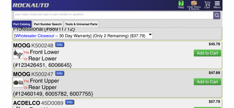

Buy MOOG problem solver next time.

Call to verify these are the “problem solver” ones from rock auto. Don’t bother with anything else. If not then Dave at hummerpartsguy.com is a good option. Also Kascar.com But do your price shopping because some things will be good and other stuff has gold weight pricing- aka hummertax.
