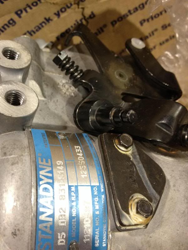

Just bought a brand new DB2831 military pump, rated at 170 hp, I missed the turbo 200 hp version, :mad2: I don't want to keep messing with fueling so should I just give it an 1/8 of a turn? I guess the only difference between the 170 and 200 pumps are fueling. Can't wait to put this baby on and get rid of my damn annoying hot start problem. :agreed:

The seller is amazing, USPS used it for football practice, bent the throttle shaft, so I had to get one out of my core pumps, so he felt bad and is sending me a factory reman pump for virtually nothing, so now, I have a few pumps for spares. Go Waste oils, :rolleyes5:
