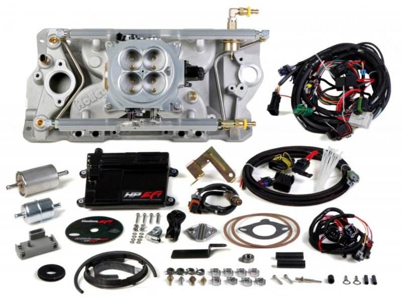

What kind of MPG's do you get now?
GM TBI is just a "dumb" electronic fuel dumping carburetor and look at the size of the TBI's small 2 barrels vs. a 4 barrel carb. A GM TBI 454 is a disappointment over a 4 barrel carb. 454's eat fuel and deserve the well earned reputation for doing so. The reputation is eating the same amount of fuel loaded or not. No reason to not have power on demand (Secondaries opening up) while drinking that much fuel.
For sure aftermarket fuel injection with 4 intake holes on the throttle would be the place to start replacing a carb.

4 intakes hole fuel injection system to replace the carburetor?
