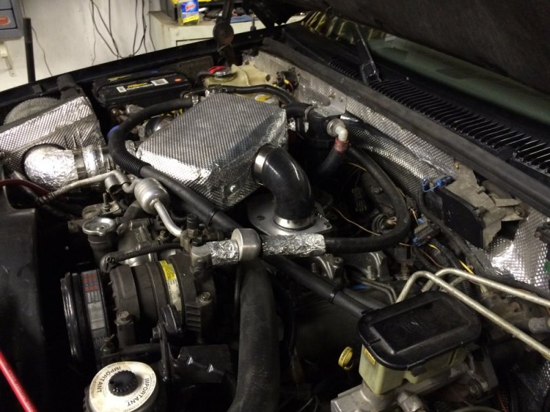

The easy place for these is in my homemade upper intake, but I don't know if that's optimal. I kind of like the idea of having them plumbed in the floor of the lower intake plenum pointing up against the incoming airstream, but I don't know yet if I have enough clearance between that and the IP lines. Any input here is also very welcome.
Here's a picture of my setup for reference. I'll try to get a picture made with labeled locations so nozzle positions can be clearly and easily discussed. It's a pretty short intake run, so not too many places to choose from.
Let me know what your thoughts are, thanks!
Just a simple fuel gauge for the water tank. Junkyard action.
Are you saying have nozzles on the bottom of the intake runners? If so, why? I would think you want them easily accessible.
I was thinking nozzles in the bottom of the intake plenum, not the runners. The idea being that if the mist was shooting against the intake air that it would mix better. Is that dumb reasoning? Yes it would be nice if they were more accessible for sure, I'm just weighing all options right now and trying to analyze function of each option so the best (or best compromise) can be selected. Is nozzle placement very important for getting the mist to distribute properly? If not it would be really nice to just throw them in the upper intake plate because they could be easily serviced and it would be easy to pop the upper intake off to machine the holes for the nozzles.

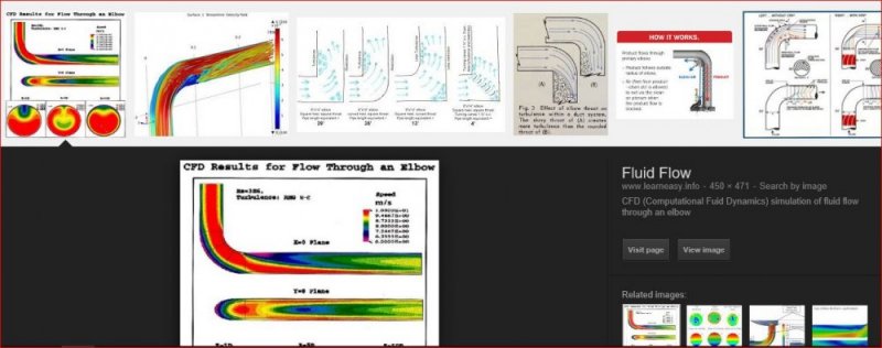

I've had an idea regarding nozzle placement: I was thinking that I could remove the silicone elbow between the intercooler and intake and use a metal elbow with silicone connectors instead. This would allow me to thread the nozzles into the elbow post-intercooler. My initial thought was to do a steel elbow with a band of steel welded to it to make it thicker for drilling and tapping. I chose steel because I can weld that at home. However the more I thought about it the less I liked steel - mostly due to the wet environment. I could paint the inside of the tube, but then I have the risk of paint flaking off into the engine - no bueno. So that means aluminum. I did some searching and found one I'm happy with....it's cast so it should be thick enough for drilling/threading directly. And it's a reasonable cost. http://www.cxracing.com/mm5/merchan...Product_Code=EB300-90-CAST&Category_Code=CSAL
So that leaves nozzle placement. I'm feeling partial to putting the nozzles on the inside radius of the elbow. As I envision air running through the elbow I feel like it would be more disturbed by disruptions in the inside surface of the elbow if they were on the outside radius. I could perhaps do the mid point of the tube, but in my mind the spray going up into the air from the inside of the radius works. Am I crazy thinking this?
I'm also thinking about just buying a kit rather than engineering one. Since that 1000psi pump alone is $250, and when I add up controllers and a solenoid I'm close to the cost of a kit. It won't have the high pressure, but it works out of the box and the controller is a more manageable size....and with functionalities I wouldn't have like linear flow of the injection rather than discreet stages. I can't imagine the 1000psi system being worth THAT much power, but maybe? I have plenty of other projects to work on, so if I can just buy a kit and install it, that could be worth it to me right now. I can always try making a 1000psi kit in the future. I'm looking at both Devil's Own and Cooling Mist. Cooling Mist has a nice 2 stage kit, but it's kind of pricey so I'm weighing options right now. Any thoughts??
I wondered about where the velocity is highest or lowest is better. I don't know if it really matters a whole lot again I don't know but here are some thoughts I have. Lets hear any others thoughts.
I think have a bung or something added so the nozzle will be out of the flow mostly if possible and have it just after the elbow on inside so its in the eddy of the elbow and sprays across the velocity "lines" from low to high. I am thinking the fine stuff will get sheared easily in the high velocity and more liquid part of stream near nozzle will be in a bit slower velocity to have more time to heat up and vaporize.

I kinda looked for a metal cobra head elbow but did not see one easily. Also did not see flow through cobra head if it has the same eddy and you could just add a riser to your upper plenum and go there on just after inside of bend then elbow with a silicone cobra????
What about having it at back of elbow spraying back up stream in the oncoming pipe. Imagine a Tee with nozzle in a dead ended tee inline with hose from IC. Again have a bung added so nozzle is somewhat flush and sprays into oncoming velocity like you were thinking coming up from bottom of plenum. ?????

Schiker, idk how it translates here, but in the mixing systems on the stuff I played on the always did it where there was less turbulence and the greatest pressure differential. Iirc it was a case of the cross flow disrupted the spray of the nozzles.
FT, I remember reading that before about the bike guys. I met a couple of those guys at Bonneville, nice guys to deal with someone just playing lookie lou (me).

Yeah, I was wondering about that and pictured a bung and recessed nozzle firing from the eddy of the elbow as might be good.
After your post and the website FT posted the end tank (air part of the IC) might be a good low velocity area and has the longest path to disperse and evaporate. Still mixingly turbulent but not higher velocity until it necks down in hose connection. What about a taller bung welded in the IC end tank so the spray is good and developed entering the end tank???.
