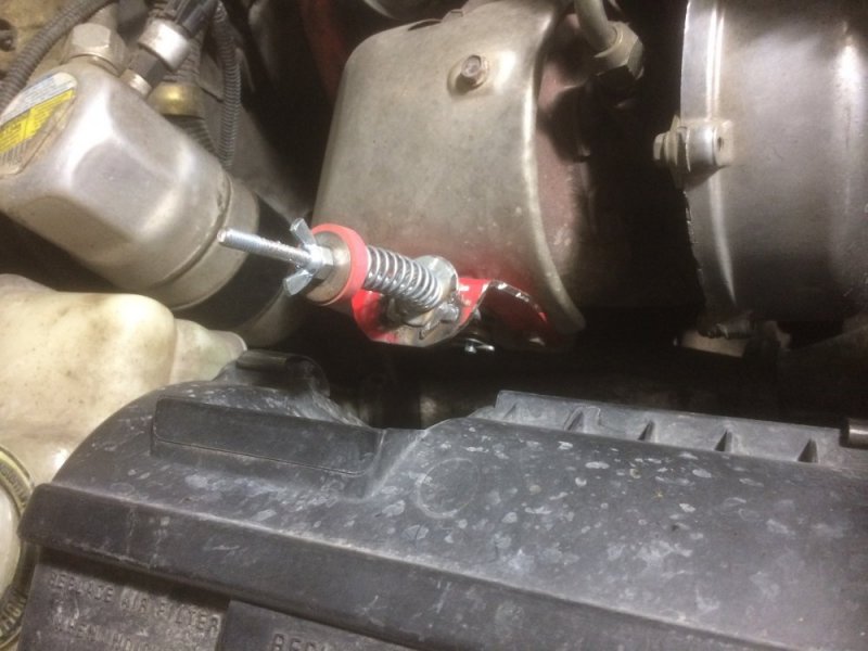

In the mean time I made up this bracket from an old bent air tank/compressor mount and built a manual waste gate controller according to instructions I found someplace on the innernet, except for instead of taking apart the good vacuum actuator, made My own bracketry.
I works quite well, I think.
Driving on the highway I have it adjusted to around 2 to 3 PSI of boost, according to the pillar gauge. On a heavy pull empty, it will get to around five or six pounds of boost.
Pulling the camper, on a fairly steep hill, it tops at around 8 pounds of boost.
At this setting, about one to one and a half turns of the adjuster nut will take it to ten or more PSI of boost.
here is a pic of the controller unit.

The most difficult part is to make sure that geometrically the actuator is the same as the original.
Unfortunately, the code will always be there at different speed, at least it is on mine.

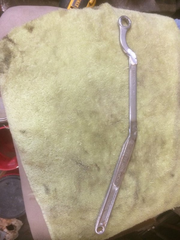

Here is a pic of the wrench that I made for the left side injector bolt.
From an old S wrench, another never used wrench then the handle was one of those multi wrench things from a bucket of wrenches picked up from an auction sale. LOL
