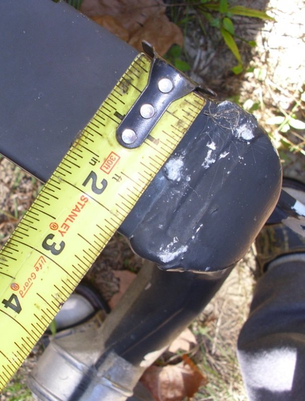

Also I am glad that you posted your measurements as I have a suspicion that my 16 housing is actually an 18cm. Wish I had measured like you did!
Ha, Thx bowtie! Fellowtraveler in the pics posted you said that an 18 was stamped but I can't see it. Can you point it out I can't find anything on mine. Thx!

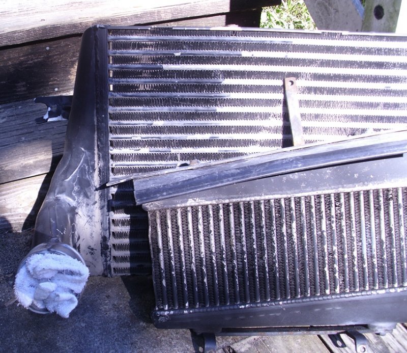

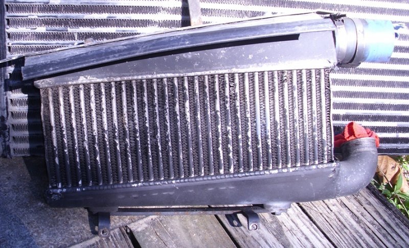

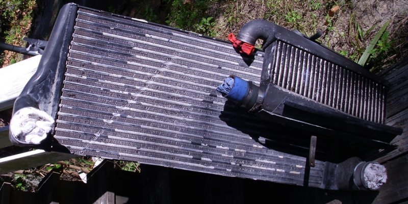

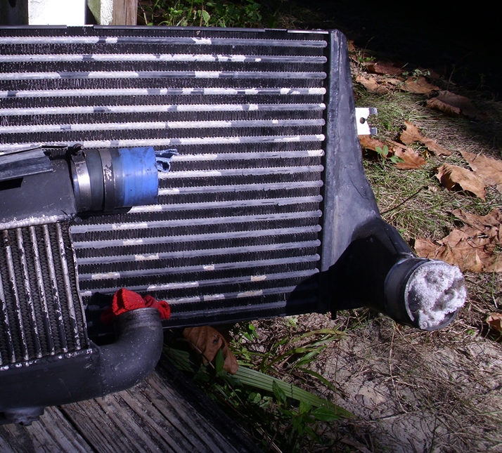

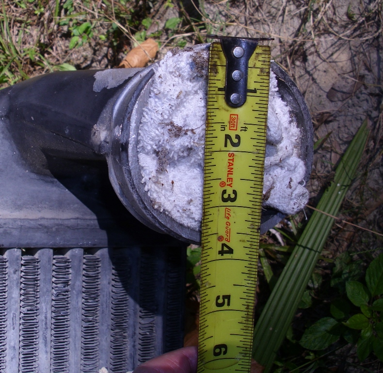

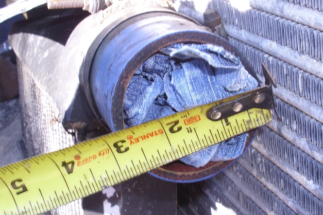

I'll post CAC/IC pictures soon my older under the vehicle one and the massive Ram Cummins CAC/IC going in front of my radiator soon. The CAC/IC pipe sizes on the older CAC/IC setup are IMHO too small anyway for the bigger HX40
Here are CAC/IC images Ram Cummins and popular 3" thick core 6.5 chassis mounted showing size difference. I found the chassis mounted CAC/IC to work better when ducted. The chassis mount allows IAT to limb when idling and in slow moving traffic, the Cummins keeps IAT in check always as radiator fan pulls air over it.
As the Cummins CAC/IC goes it fits under dual headlight grille w/o having to mod lights or CAC/IC things to consider are aux coolers when using this CAC/IC the pipes will enter under battery shelves so those w/windshield washer jugs under battery must relocate it.
CAC IC 001.JPG CAC IC 002.JPG CAC IC 003.JPG CAC IC 004.JPG CAC IC 005.JPG CAC IC 006.JPG CAC IC 007.JPG
Is the Cummins I/C out of a 91.5-93 first gen, or later model truck?
It's 1994 + up, the core sizes are Cummins 1,188 cubic inches the popular 6.5td chassis mount CAC/IC is 378 cubic inches if going w/ducting for the smaller CAC/IC then minus the width of the fin openings from the overall core size to come up with duct inlet opening.
Another requirement to make things easier installing the Cummins CAC/IC is to use the Dodge Ram Cummins radiator which is recessed to fit between the CAC/IC in/out ports or use a narrower GM radiator.
