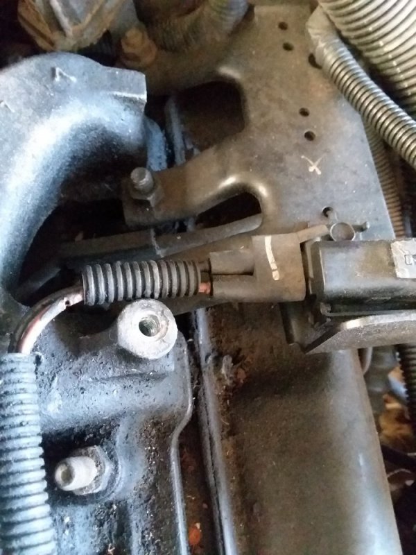

There was a hole in the orange vaccuum line in the picture below. The fuel tank needed replacing due to full of rust. And a fuel line was kinked under the fuel tank. The fuel lift pump went out on a travel trip back home was replaced at a rest area to return home. Temp sensor quit registering on dash gauge. Radiator metal reservoir cap had stripped plastic threads on resevoir so that was replaced. Relays and sensors replaced due to codes. This truck was purchased from a man that didn't drive it for quite some time. So due to none use of vehicle and I'll schedule of maintaining things needed fixed. The truck has 160,000 actual miles and was purchased at a great price. I was aware of some of the issues at purchase. Sorry I didn't realize I should have been more thorough instead just checked. Most of the suggestions I had previously done before posting. Just thought I would see if there was something I had not had checked or repaired or replaced that was causing the code P0238. I didn't mean to cause a critical moment. My apologies.

The pic is above , not below.
