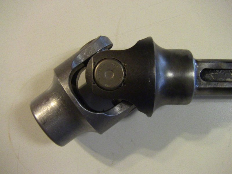

I have a 96 chevy 2500. 2wd. And I need to change the steering box, steering shaft, and basically the whole front end. O, and the exhaust. My friend gave me a 99 2500 just like mine. Everyone I've talked to says the parts are compatible but when I look online I can't get a straight answer. Please can anyone give me a straight answer
Steering gearbox and shafts should interchange no problem. May want to replace the hoses going to the box while you're at it, if corroded at all the nuts won't swivel on the steel lines and just twist the lines until they break.
When you say front end, keep in mind there are some significant differences between 2wd and 4wd models, like lower control arms that aren't interchangeable. Double check part #s as suggested before tearing into things
Welcome to TTS... The steering gearbox will interchange without a problem.. I agree with diesel amateur change your hoses... You're already into it better off saving a problem later.... I've done a lot of front end work on my truck lately... Tell us what all parts you're thinking of changing and we can guide you as to which ones will interchange and or which ones to replace with new.... As a side note do not I repeat do not buy tie rod ends ball joints pitman arm idler arm etc from a chain store like AutoZone or advance... Made that mistake.. they're crap had to change them again 6 months later.. get good ones from RockAuto
