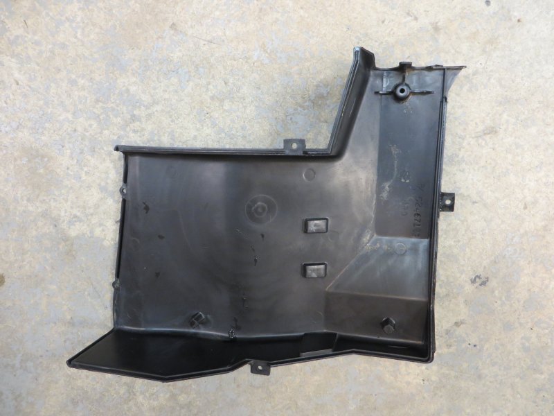

I'm in the process of replacing A/C components & also had a leaky heater core. Thought a pic of the heater core cover (firewall side is top of pic) would be helpful to show folks where the difficult to get at screw is on the cover. The cover wasn't too difficult to get off in my case.
