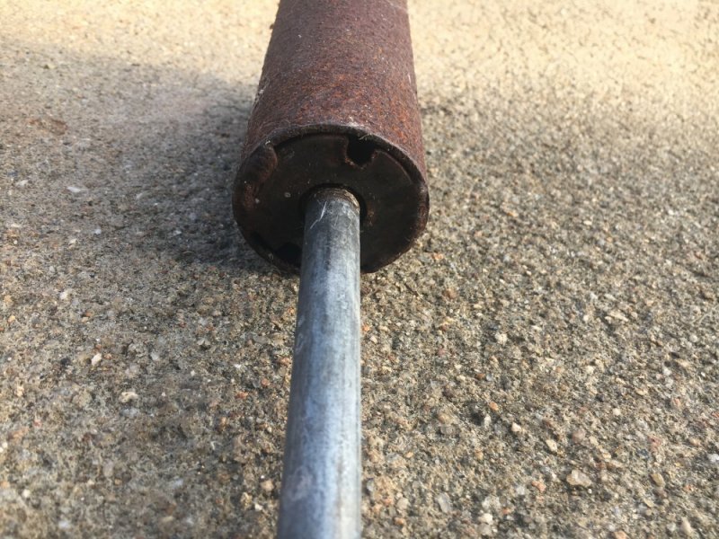

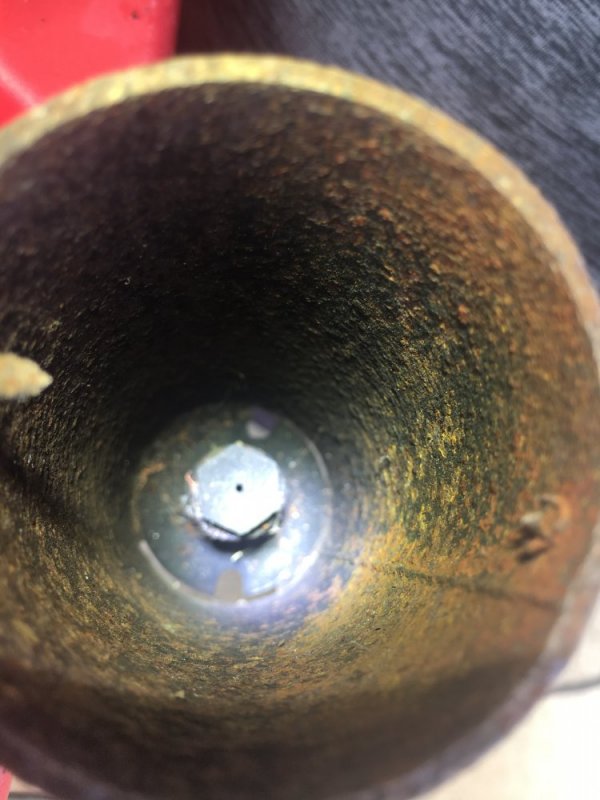

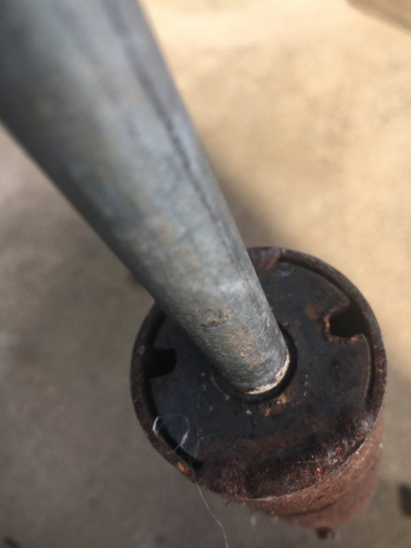

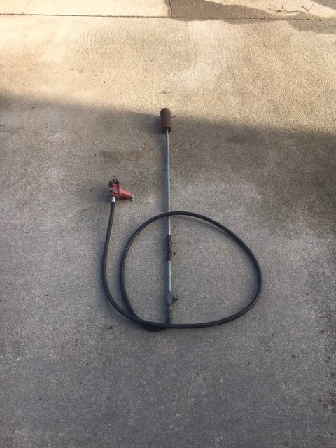

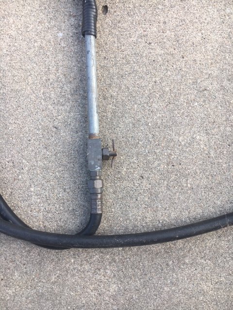

I use a home made single burner and have a store bought one. Here is home made one.

My home made torch has a regulator the store bought does not. I think a standard OPD valve will require some back pressure so you'll have to have some down stream control.
You probably will have to 2 stage regulate if you have a lot of torches.
