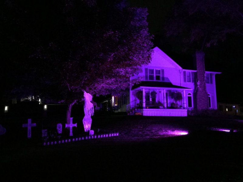

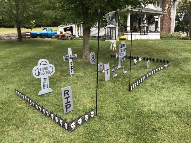

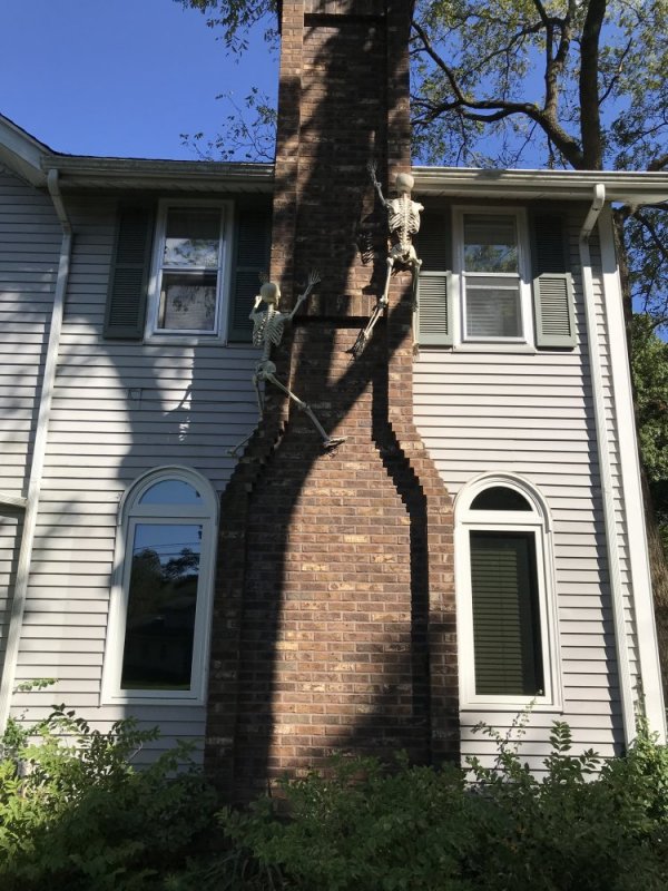

For a few years now we’ve been decorating our front yard for Halloween. The first year had some lights and grave stones and then each year after that we’ve ramped it up a little more. Last year we were up to a couple skeletons climbing the chimney and some front gate posts with solar lanterns marking the front of our cemetery.

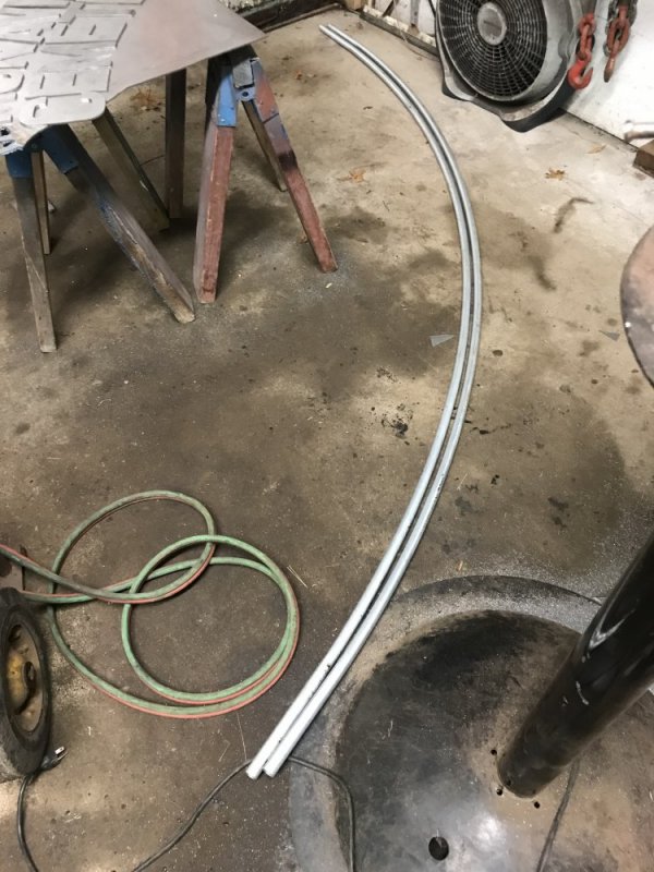

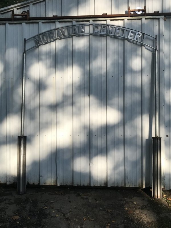

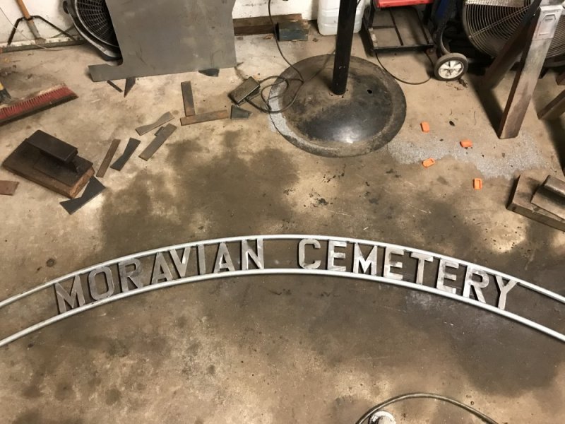

So that solidified the plan. Now I’m starting on it. Yesterday I rolled some 3/4” EMT conduit at work for the top arch. I chose EMT because it should be strong enough for what this is, but I need it to be portable because we’re not so crazy that we’ll leave this up year around and this thin wall steel will be light.

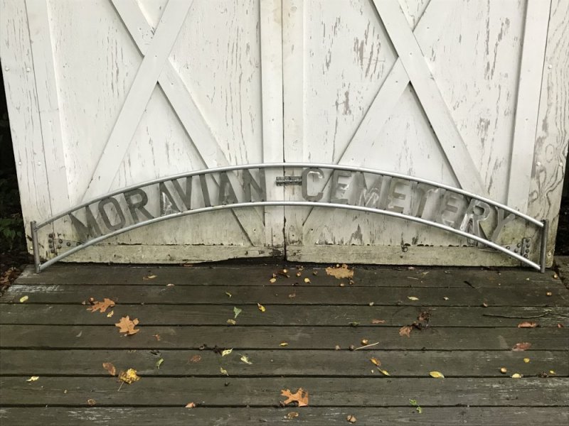

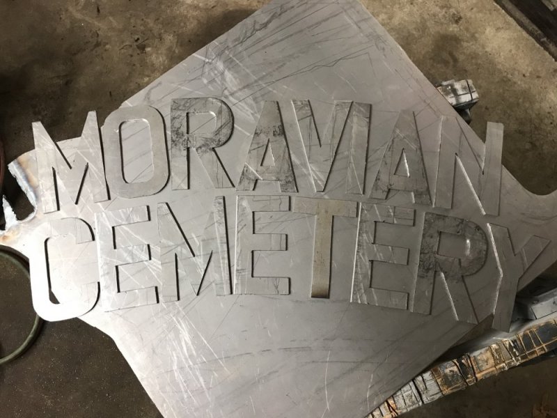

And then today I made the letters for the top. I had a chance to have the letters made at work on the plasma cutter, but I wanted to make them myself so I could say, “I made all of that”. At first I tried oxy acetylene to cut them out of some scrap 10 gauge steel from work. I thought the rustic cut would look nice. Nope. Too rustic. So band saw and sabre saw it was. It took all afternoon, but I have the letters I need. Even with the saws they’re still a little rustic, but they’re just fine for what this project is.
Tomorrow I’ll start welding some subassemblies for this. I plan on make it in 3 pieces - the upper arch and 2 posts. It should be strong yet manageable that way. At least that’s the plan.

Today I got the upper arch put together. Right now it’s just tacked together, but all the pieces are in place.

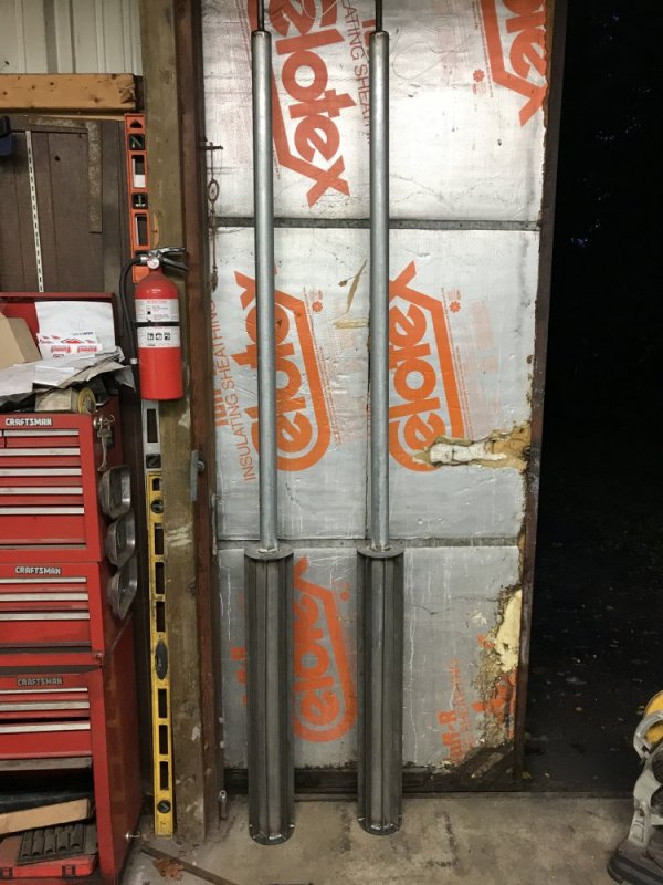

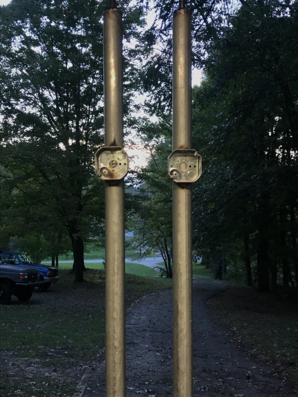

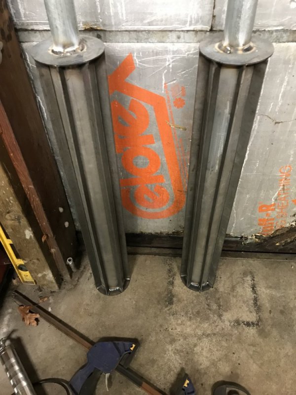

Then I worked on the posts. The lower portion is made out of 4” exhaust pipe. Then I added some 1/8” x 1” strips to that to give some extra dimension. The upper part is 2” EMT, again to keep the weight down. I made some long 3/4” studs at the top to fasten the top on. I got them welded together just before dinner time so I didn’t get them cleaned up yet.
I also hoped to put the 3 pieces together just to see it as a piece, but I didn’t have time for that. It should look fairly impressive though because it will be about 7.5’ wide and 9’ tall. More tomorrow.

Then I added the boxes for mounting sconces to it. No the original doesn’t have lights on it, but I’m not trying to make a faithful recreation - it’s just inspiration for what we want in our yard.

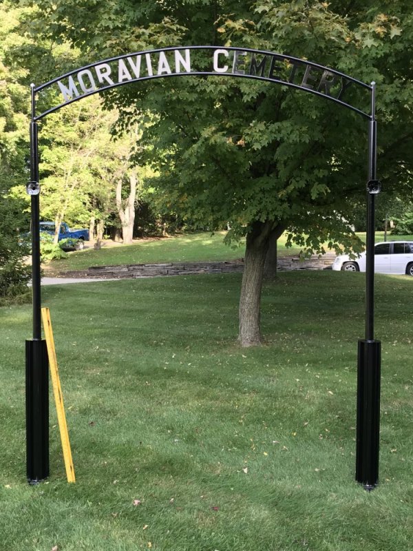

I had some delays this week, but finally managed to get the gate done enough for this year.

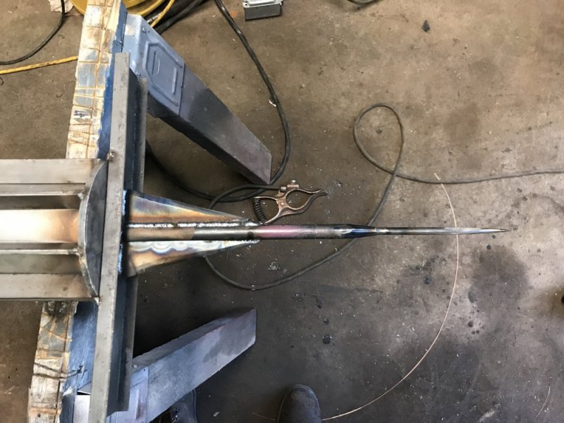

I added some C channel to the bottoms of the poles and then made some 16” spikes to go into the ground. I made gussets for the spikes and ground the edges to a point to make them go into the ground easier.
The poles go into the ground like butter and seem stable enough. I painted the three parts with black Rustoleum. I assembled the gate on the ground then with a little help lifted it up into position. I’m happy with how it turned out overall. It will be fun adding more embellishments to it over the coming years.
That’s a 4 foot level leaning against the post for scale.

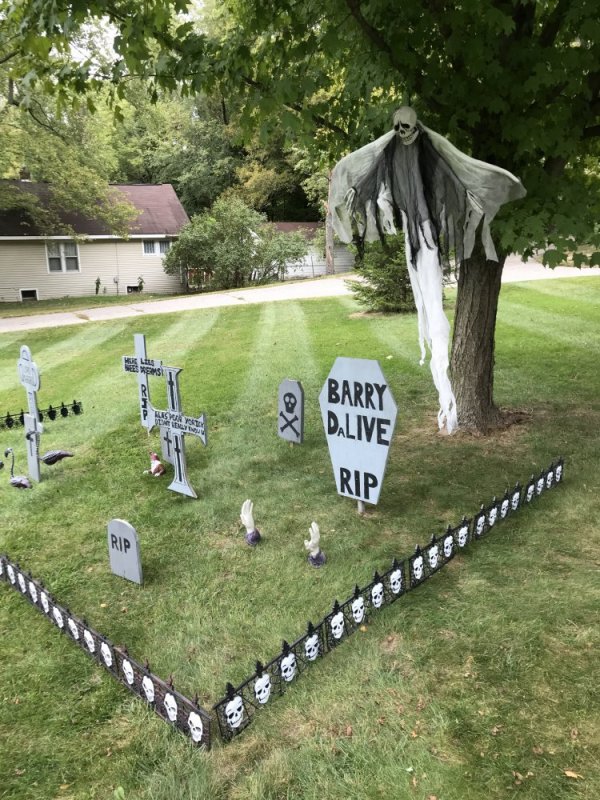

Next I added the light fixtures to the posts. I like the little extra that the lights add to it. We also added some cheapy fence from Menards for the border of our cemetery. The tombstones will be put in place tomorrow night.

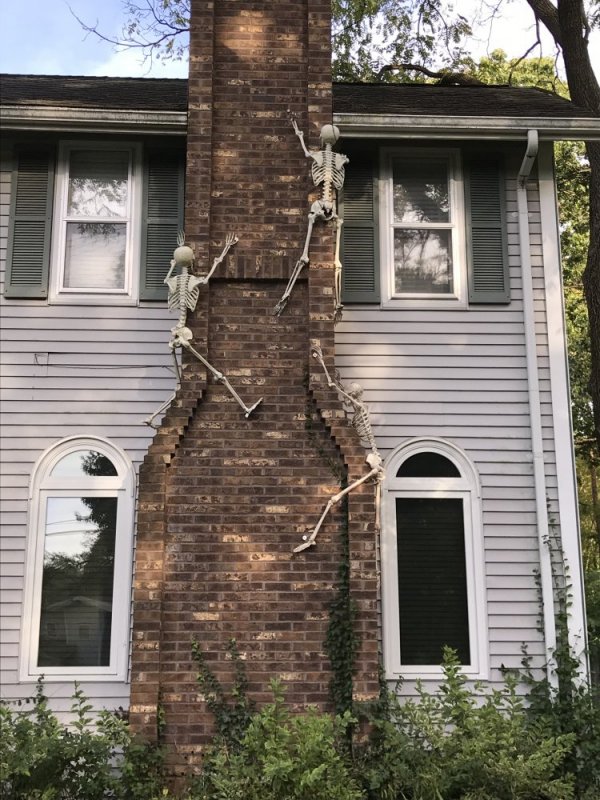

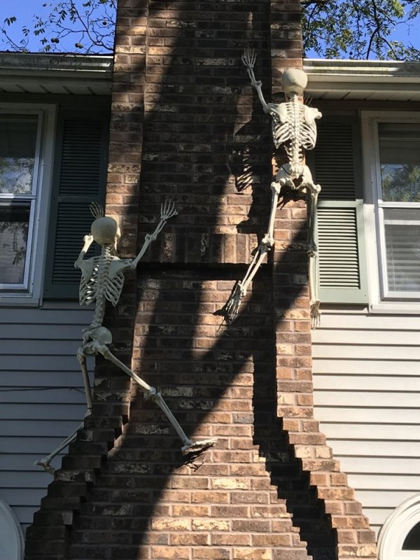

I also got the skeletons up on the chimney - the lower one on the right side is the addition for this year.
