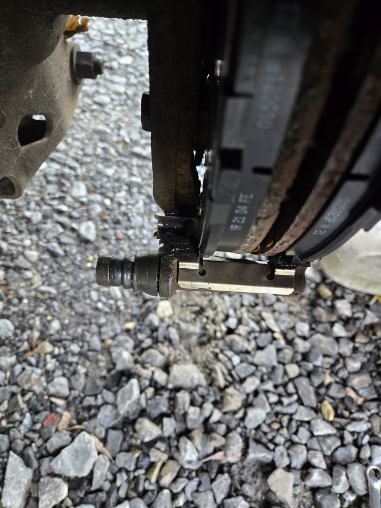

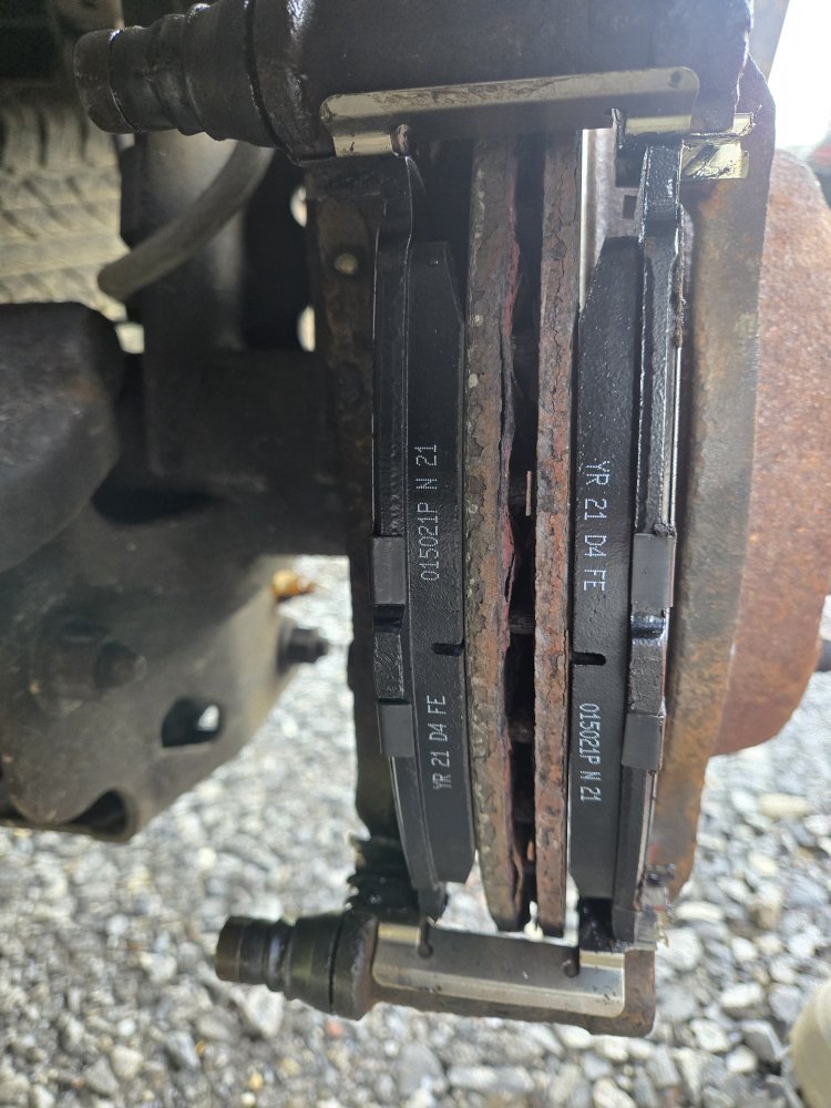

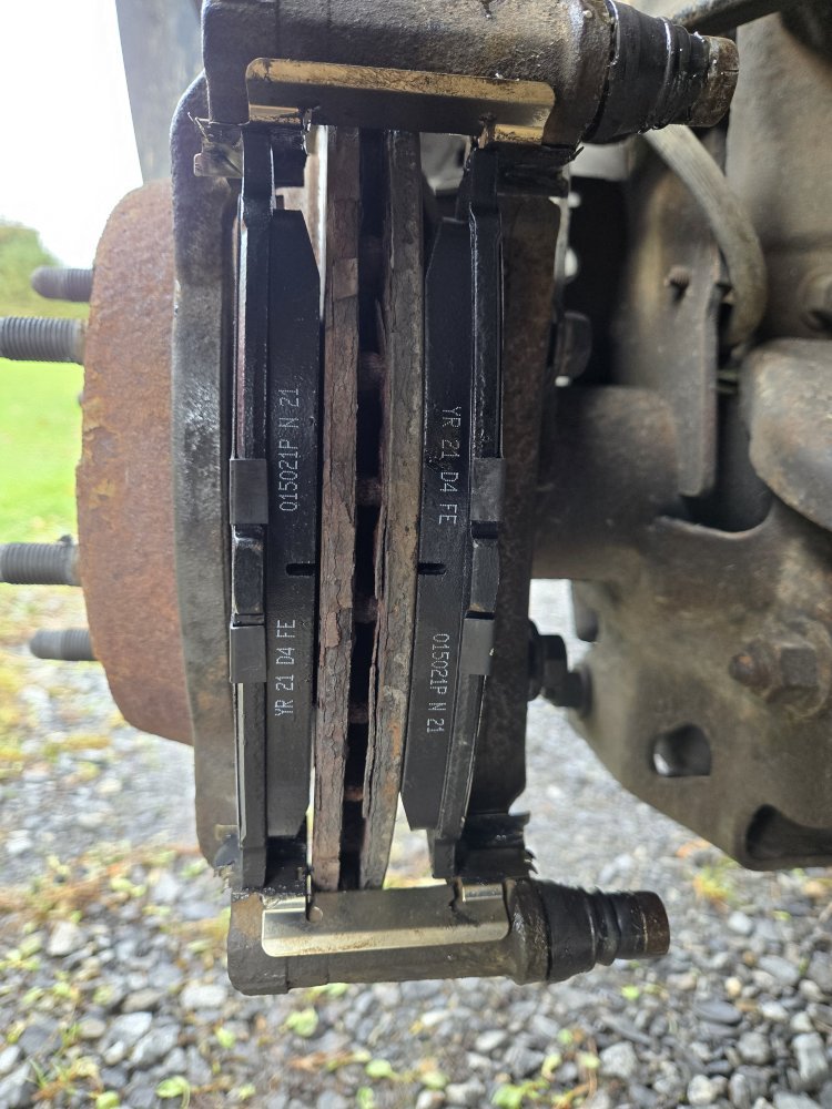

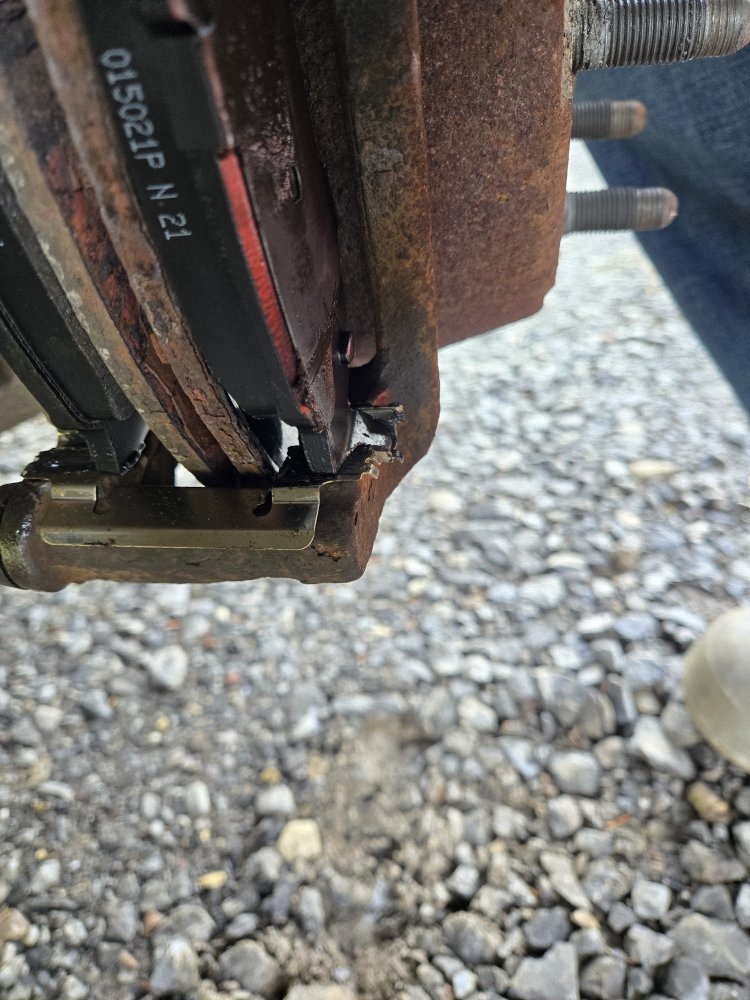

Not entirely sure whats wrong yet, but it doesn't look right. Look at how the new pad sits in in the mount on each side of the rotor. Notice a big difference?
If you can't tell via pad and mount, look at where the rotor rides in the opening of the bracket! Its not centered even woth the bracket tightened down.
I've been having pad issues and a clunking coming from the rear passenger. What i found was the pad was so thin, it could nearly slip out of the mount and fall out! The calipers are NAPA remans, the rotors are Detroit Axle brand from either the Jungle store or eBay. My gut tells me these rotors are either not correct for my application, or are manufactured sub-par in an overall narrower fashion. I've got about 10k miles on the rotors this way before just realizing this. I need to get my hands on another set of rotors and measure the thickness.
I was just gonna say it looks like those rotors are really thin! the inner pad isn't sitting on the slides and could easily slip out from what I can see.
the other thing too with the spindle where the caliper bracket mounts. I'm sure you had to remove the bracket, check that surface where the bracket sits and make sure rust hasen't bulged out creating an offset for the caliper.

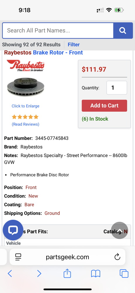

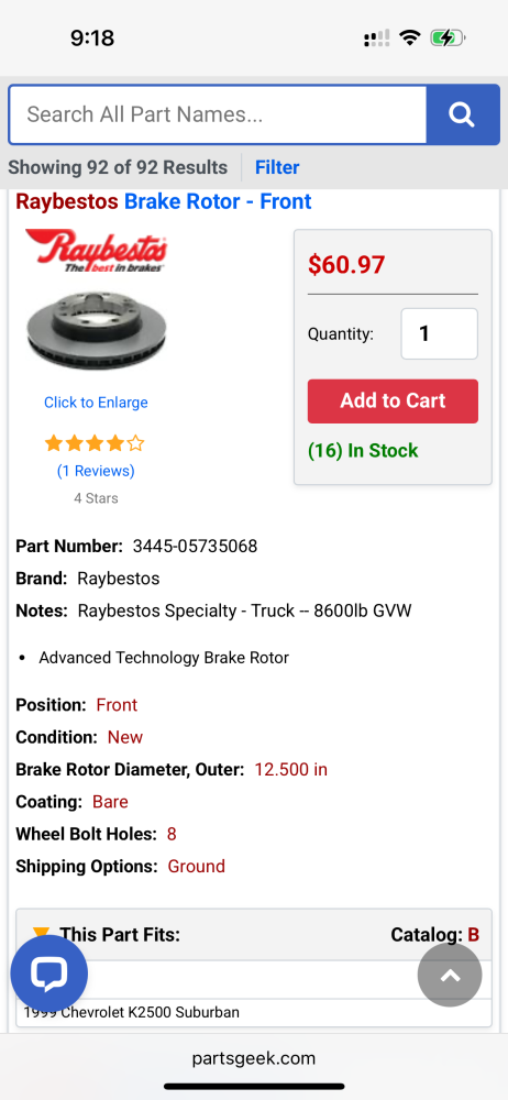

Go to PartsGeek.com as they are way cheaper on rotors. The Raybestos Advanced Technology Rotors are the same as the top end AC Delco. Screen captures of slotted and regular Raybestos for GMT-400 front:
View attachment 96829View attachment 96830
RockAuto will gouge you for shipping cost on rotors.
Raybestos and AC Delco are at the bottom of the page linked above.
I will check this site out next time. Never heard of this one.
I have ordered parts through them, IIRC they was dependable and seemed quick on shipping, but, its been a while.
I’ve recently ordered Raybestos slotted front brake rotors from PartsGeek.com. Their price was about half what RockAuto.com was asking and their shipping cost was far less. Order came timely. No issues. Ready to order more.
