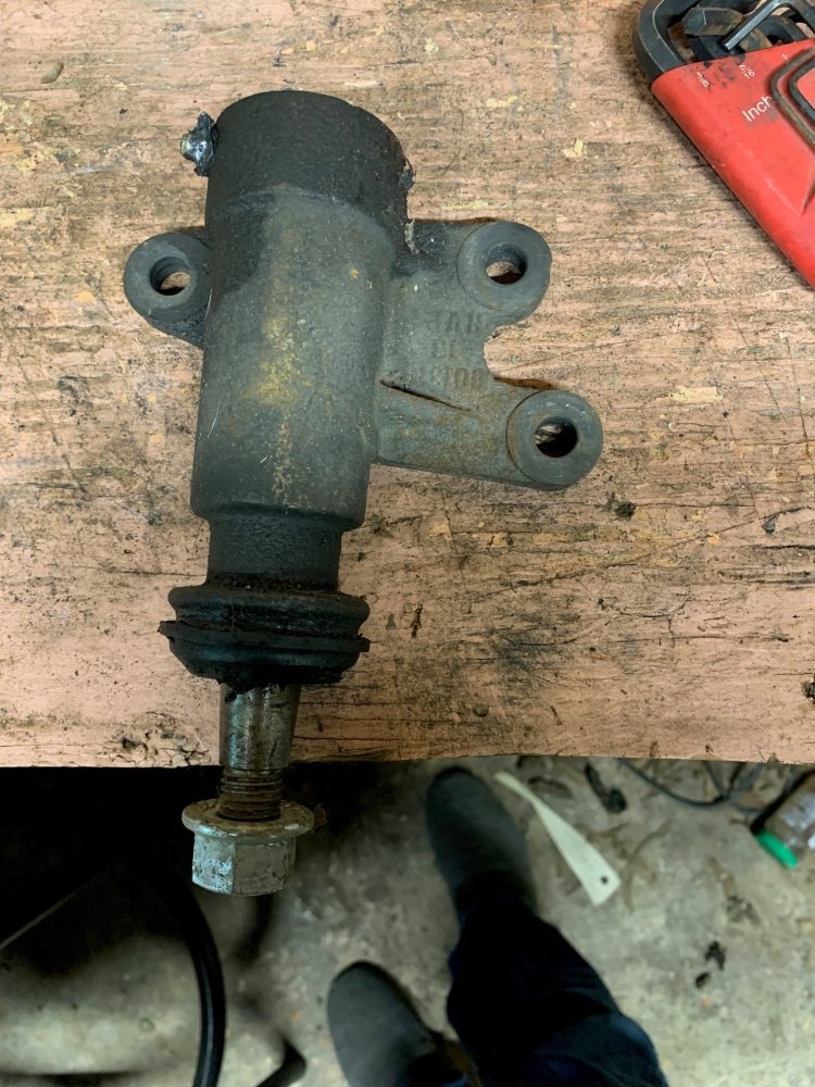

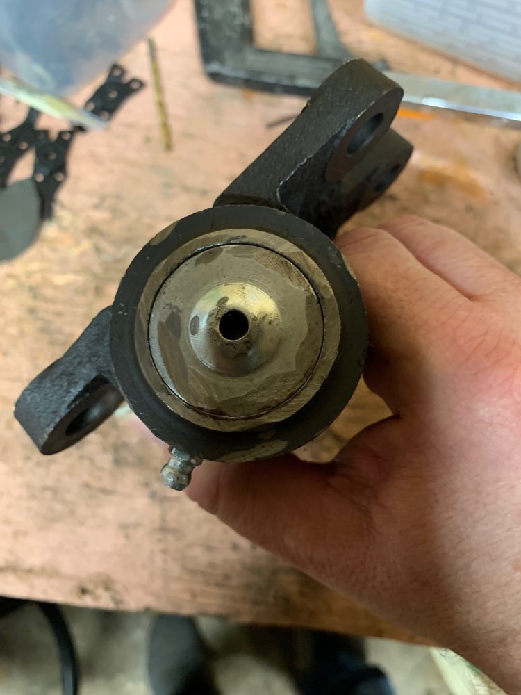

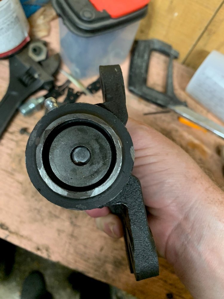

my last one I pulled from the truck I had saved in the parts bin for a later date thinking I could do something with it. well that time has come where I decided to tear it apart and see what has been causing them to fail so quickly.
I took it and saw where the end cap was crimped on by machining so i decided to grind the machine crimp off and pull it all apart. Here is the photos of it before getting my teeth into it...

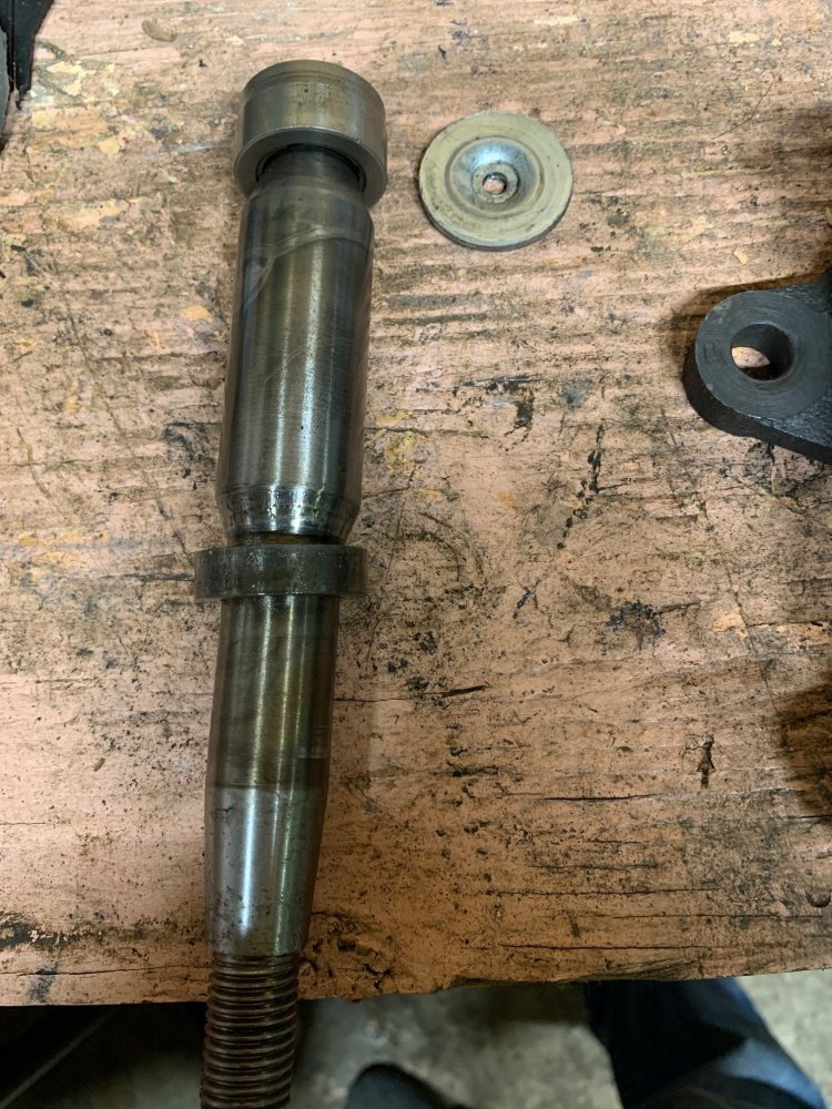

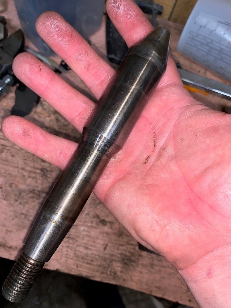

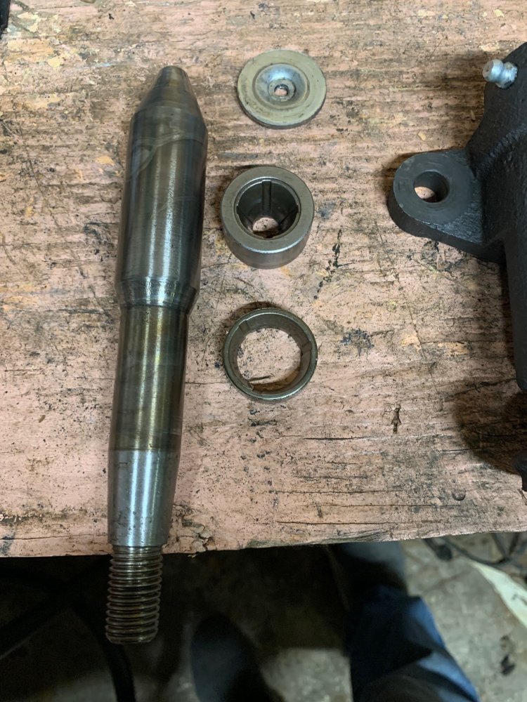

I took the end and ground off the ridge that held the end cap in place, then popped off the cap, removed the internals and cleaned all the grease out to inspect and see what was worn out.

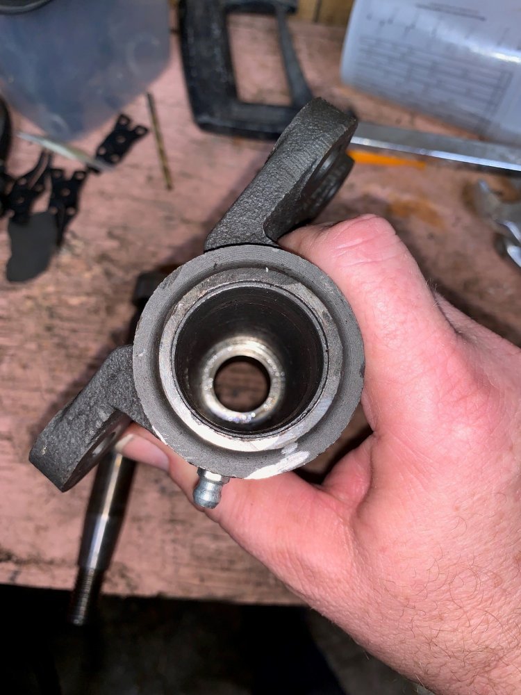

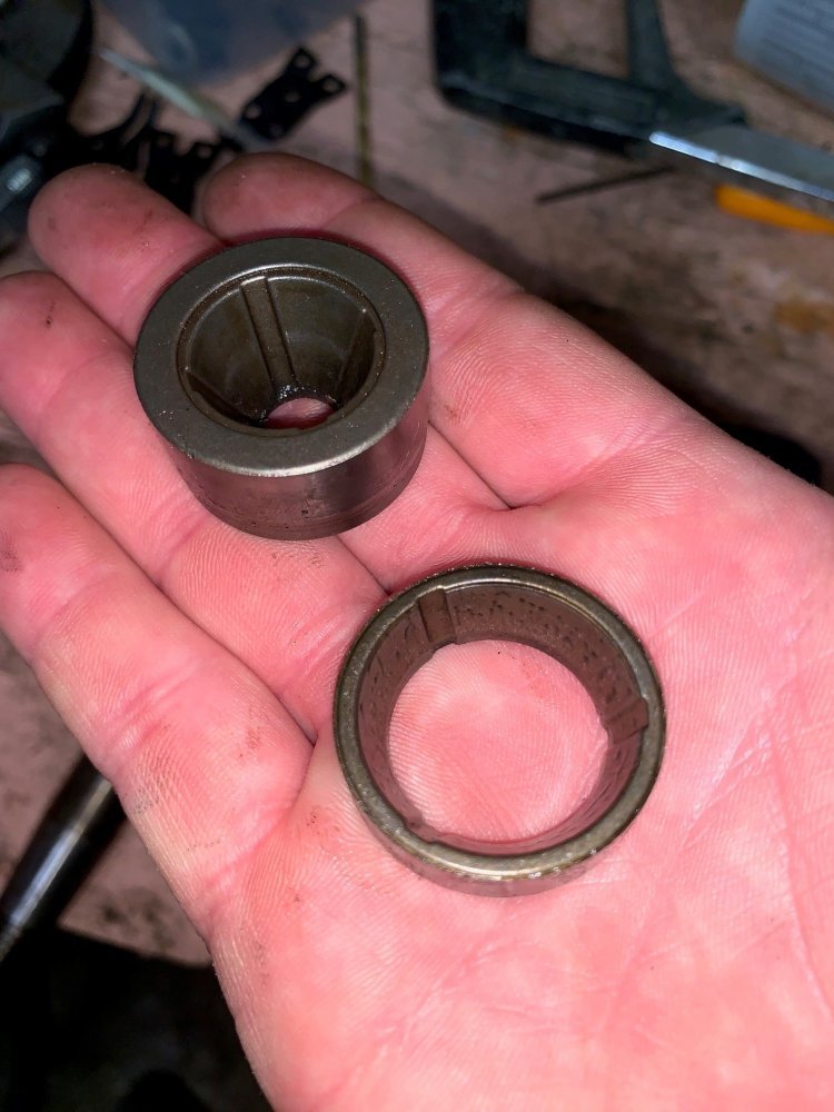

one thing I noticed was it uses tapered steel bushings the are supposed to apply pressure at each end keeping the shaft straight. I found two issues in it's design. the first on is the top bushing (larger one near the cap I ground off) was loose in the housing and can slightly move side to side. the second issue I found is there is also up and down play where there is a gap between the top bushing and the end cap and nothing holding holding or applying pressure on the bushings to keep the taper in place causing more side shaft movement.
the lower smaller bushing is loose fit but has a closer machined fit so it doesn't allow any side play.

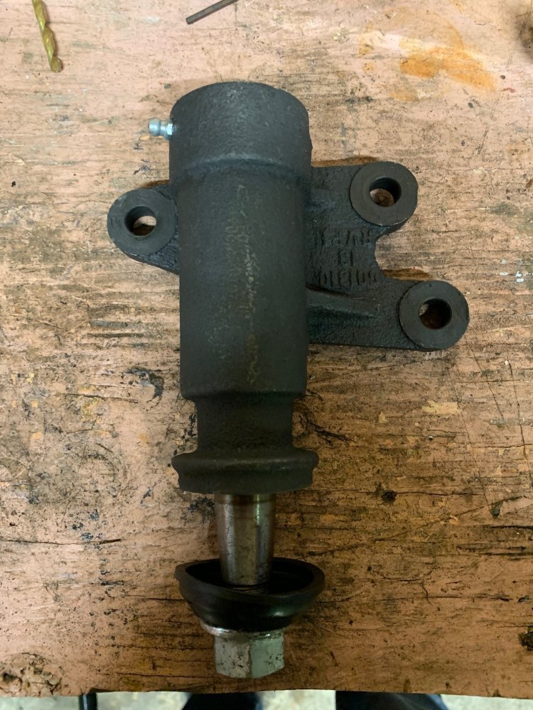

Here are the photos I took of the unit after I cleaned it up and gave my initial inspection.
idler 3.jpgidler 4.jpgidler 5.jpgidler 6.jpgidler 7.jpgidler 8.jpgidler 9.jpgidler 10.jpg
My first initial thoughts are on trying to make this thing better and not have any shaft side to side play is this...
the top bushing has play in the housing, Also right where the bushing rides in the housing, the grease zerk is threaded into the housing as well. I was thinking about using that threaded hole for a set screw and putting some preload on the bushings while tightening up a set screw in those threads. maybe even drilling and tapping to other holes to allow me to center the bushing in the housing and hold it down. three is better than one LOL
then drilling and tapping a hole further in the center to use for the grease zerk. tack welding the cap back in place and see what happens. The top cap has a hole in it that I would assume to allow a weep area for grease the escape out of as well as where the shaft comes out the bottom. both bushings are slotted to allow grease to pass between them and the shaft area that rides them.

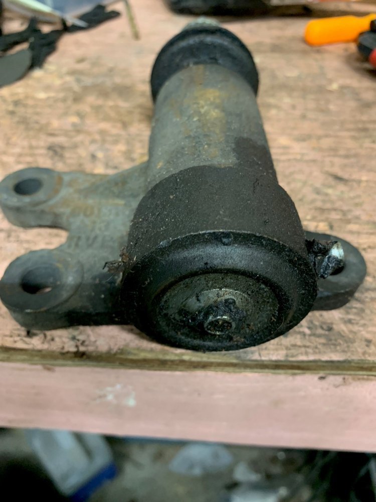

the shaft did have some discoloration on it but the whole thing wasn't on the truck very long. I could have gotten warranty on it but didn't. this one isn't a Delco unit. it's a moog from advanced auto. I went Delco for it's replacement which is now failing with what I'm assuming the same issues.
I probably didn't elaborate on how much the top bushing is sloppy in the housing (end close to the end cap) I could probably wrap a business card around the bushing and fit it in there.

Well after toying with this old idler arm bracket and shaft, I think I have figured out how the take 95% of the slop out of the shaft.
I pulled the grease zerk out of the housing and screwed in a find thread 1/4" bolt. that alone will keep the top bushing from moving around in the housing. I toyed with it further and found a flat washer that was the right thickness to place between the top bushing and the cap I ground off. it alone will all me to apply a slight amount of pressure pushing down on the assembly taking almost all of the slop out and still allow the shaft to rotate smoothy with no up and down play.
I am thinking that I just need to get a small piece of metal I can use as a shim on the opposite side of the bushing so that when I tighten the bolt as a set screw, it will keep the bushing and shaft more centered and lock it down. and with the washer in place I can tack weld the top cap in place.
the flat washer had a hole in just the right place too so that I can use the hole that's on the cap which there was a threaded plug there I can install the grease zerk to get grease into the housing.
I mocked this up with the unit in my bench vice and fastened the box end of a wrench to where the idler arm goes just to see the before and after effect on the amount of up down and side to side play. with an "arm" attached to the shaft you can see a real difference on how far it moved and how it effected the center link bar on my steering. with the added washer taking up the space and the bolt cinched down. the "arm" (my wrench) has very little to no movement and the shaft still turns smooth without any resistance.
