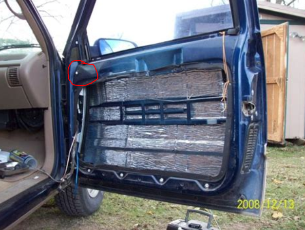

while I had the panels off, I noticed a 5/16" hole in the door inner skin that had some reinforcement around it. straight across from this hole there outer door skin in that area also has some extra reinforcement as well. I was thinking of getting a nut insert in the hole and installing a short piece of allthread with a rubber foot on the inside so that I could run it down to apply some pressure on the outer door skin pushing outward to help make the outer door skin more rigid for the mirror since the weight is pulling down on it.
one thing I also noticed is that the outer door skin flexes even more when the window is down. any ideas or tricks others have done to strengthen the doors on these rigs?
Here is a random pic of the inside of the door I got online where I circled about where the hole is in the inner door frame, location I was thinking of adding the above rubber feet to push on the outer door skin for some support.
