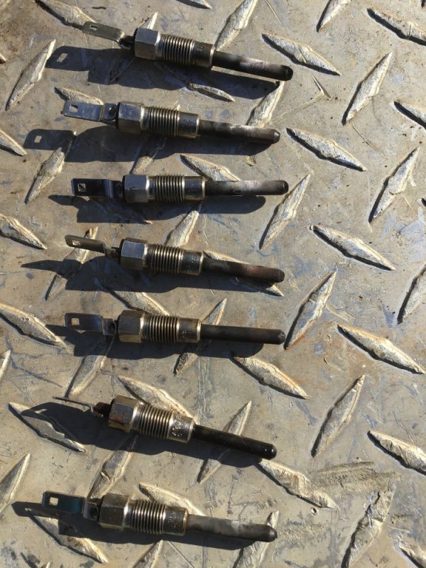

When he taught it I never messed with water heater elements, but brought up the 6.2’glowmplugs and glowplugs. I had a habit of saving my old parts just in case needed. I also used to label which cylinders on glow and spark plugs- something picked up at the dragstrip. He had me bring in parts and we tested all my old and even tested plugs in my engine, then pumled the ones from my engine as he explained meggers and fine resistance into the block farther from the ground cable. I actually learned I had one bad injector and another going bad because of the recorded history how two cylinders were wiping out glowplugs at a faster rate than the other 6.
So when I later worked in the fleet, I argued the point with bosses and thats what started the testing of plugs out of the engine. Thats when we found that good plugs can actually test bad, and bad plugs can actually test good when using the resistance as diagnostics. Btw, using amp will do the same thing, except make false readings worse because of bad grounding at plug, cable, etc. it is good to help learn of grounding issue- but doesn’t prove bad plug. Same reason when you amp test a starter, if it fails you the remove and bench test the starter and redo the amp test and if you variable is more than 1% you are to remove and clean grounds, and test battery cables with a megger. Then there is this fun factor to add in. When we were testing them in the shop one guy randomly grabbed 2 as comparisons right from the box and had a reading one at minimum ohm spec and the next at maximum- it was a hilarious example of mass production at it’s worst. So he checked all 32 new ones we had in the parts room. Thats when we actually bench tested them.

So in the fleet what did we learn was the best method? When a hard start is noted, waste no time testing something that will give a subjective answer. Quick voltage check if one is getting power shows power good to plug. Then Grab 8 new plugs and swap them in and eliminate down time. Then you can put 4 in a vice easily at same time with a singe jumper lead with a battery jumper box (ground to vice, positive to lead) then the next 4. About 2-3 minute test and you knew which to reuse and what hit the trashcan. Use needle nose to remove connection and let the 4 fall or wear welding glove because they are hot a minute after testing. If you don’t have a vice at home, test one at a time.
Remember the contamination issue? Own a stainless steel wire brush and SAFETY GLASSES? Get it hot, disconnect power and a quick swipe on two sides. Rehook up power and use your temp gun again- ya might be surprised. We learned dont do it while they are energized and full hot because they look like a 4th of July sparkler sometimes depending whats on it, and yall know I am not safety sally over the top- so when I say safety glasses- believe it.
