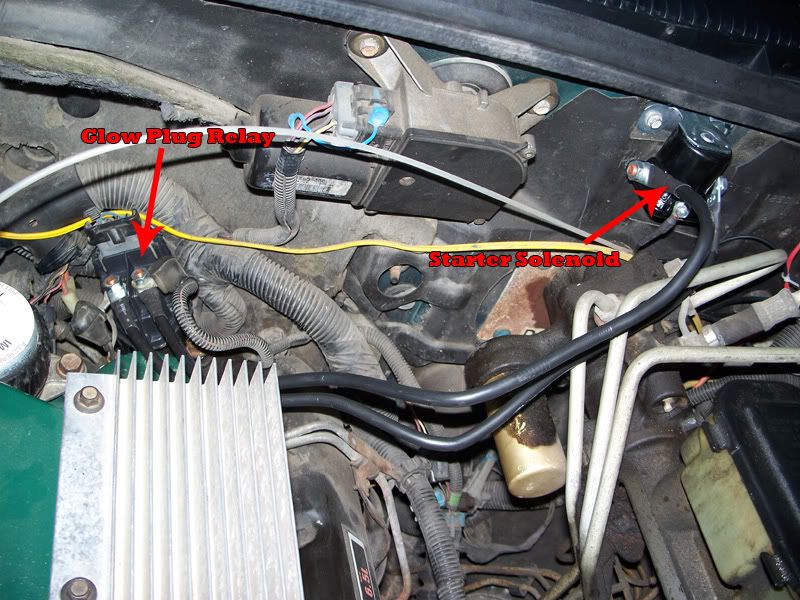

Hello all!! I finally got around to installing a Glow Plug realy to extend "Glow" time. Posted some pictures. Hope it helps out.
Stock GM, Glow Plug Controller, Upper left around 11:00 Area.

Nice job! You've just been added to the 6.5 Technical Reference Library!
Nice Install.
Mind if I add some of my the pics from my install a little while ago?
You guys think my button looks almost OEM? lol
And some install pics.
I took my bezel off because I was installing a different switch for my high idle :).
