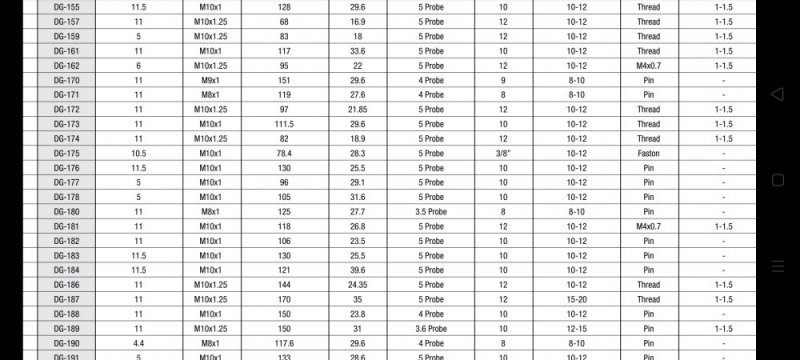

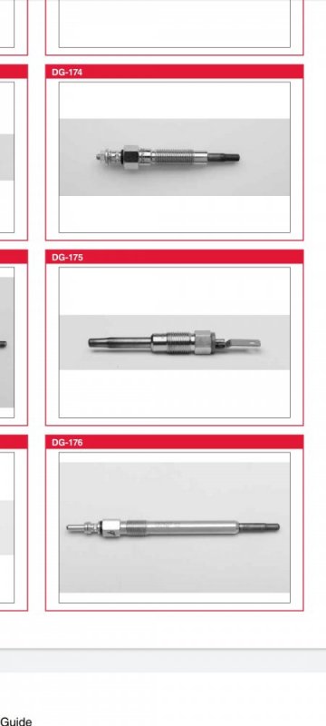

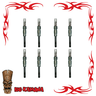

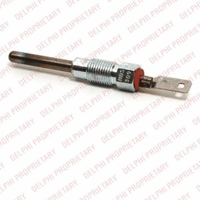

I wonder who makes these?
I'm thinking that an ammeter might be a better way to check. I should put one on mine with 8 fresh ones and see what it draws.

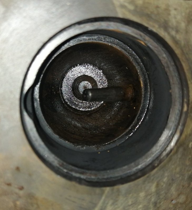

During a glow plug inspection if you note they have a rough texture, like rust but not, it indicates too much timing. Aka eroding the glow plugs. This may include weak injectors popping too soon. Replace the damaged glow plugs and fix the timing problem. If you are hot rodding you have pushed the timing too far.
