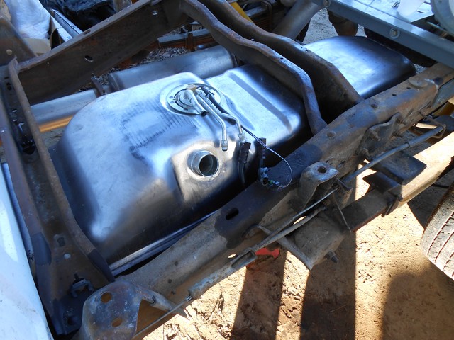

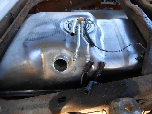

I now have a new fuel tank, sending unit, pump pre-filter, Walbro pump, AN fittings.

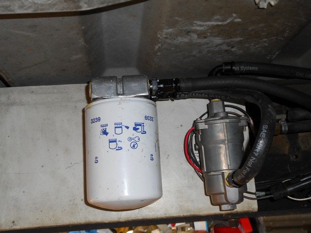

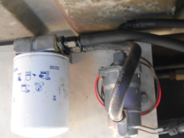

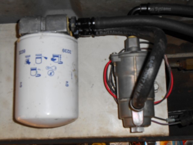

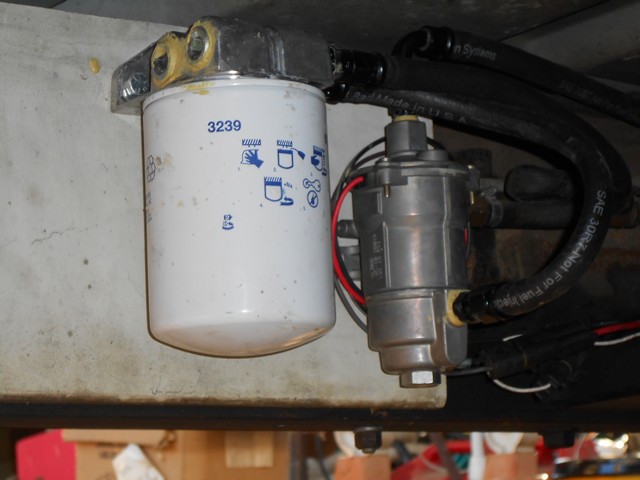

Planned additions will be to replace the hard lines from the tank and add a redundant Walbro behind the filter on the plate with enough capped off lines to put it into service in case of a future failure on the main pump.
I don't like laying in the mud with diesel fuel running down to my armpit in the dark. I may even rig up a mounted light source for that area!
