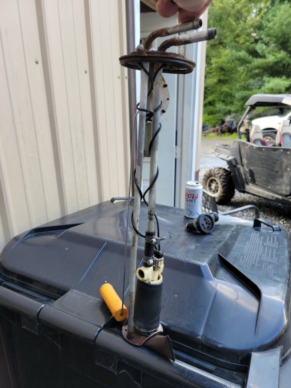

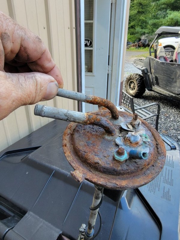

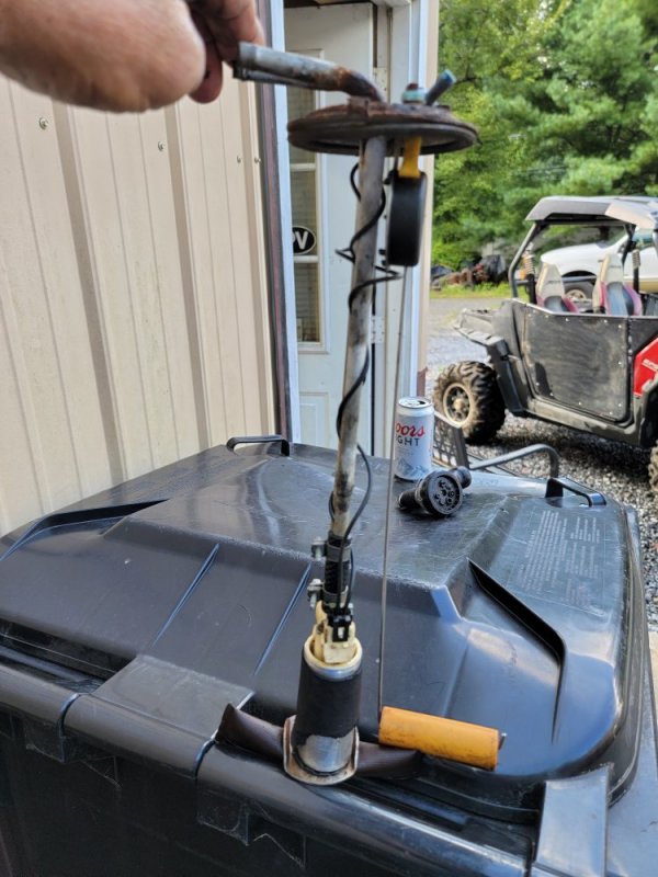

not only that, but since you are dealing with a gasoline vehicle, there are safety concerns with the tank you have, the sender in your pics doesn't look like it has any vapor lines or a vent. with no way for vapor to escape the tank or vent it's self with filling, static electricity is an evil enemy! Honestly the complete new tank assemblies for these trucks are under $150. when I was pricing a tank for my rig, I found a 34 gallon replacement OEM tank was slightly over $100.
