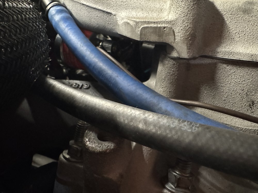

I also have that restrictor fitting, from Leroy Diesel, installed on the coolant pump bypass fitting.
Restricts some of the coolant from flowing straight back to the radiator.
That might help with internal temps too.
