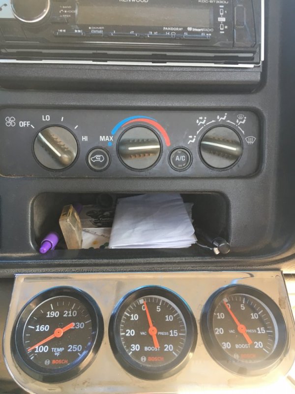

And add in the fuel pressure gauge tapped at the ip. Even if no gauge for now- put in fittings and plug it off until the gauge shows up. I am using electric this time with one sensor at ip, one before the ffm (leroys ffm adapter works for that). Later when I do a wazoo lift pump and prefilter I will add another sensor before that filter.
