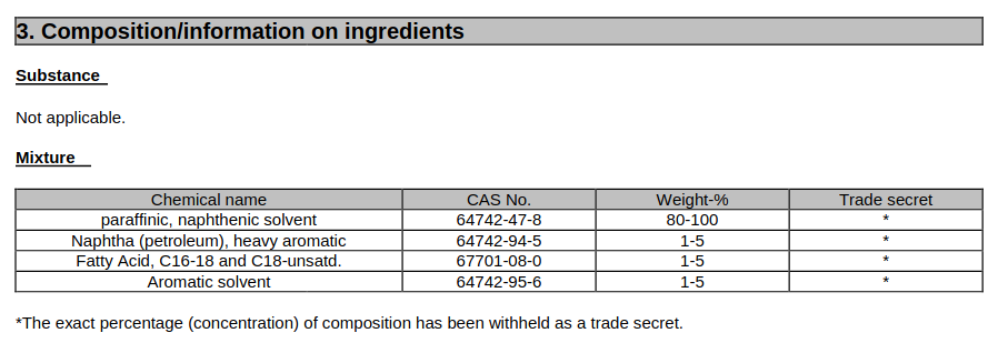

Here is an exert from Stanadyne Lubricity Formula. it shows the main ingredient to be paraffinic and naphthenic solvent, paraffinic solvent has the old sulfur in it's crude form. makes sense for how well it should lubricate in diesel fuel. it uses a mixture of both. I need to find a local place to buy from. so far the only place I've found is on the jungle site.
