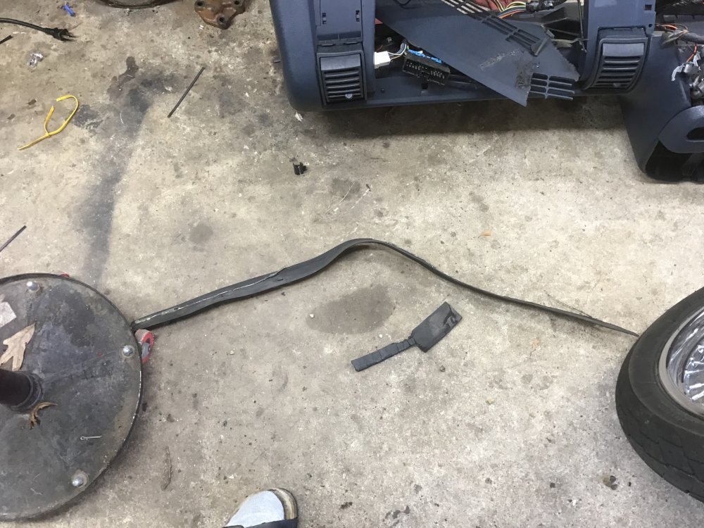

Hi all, what is everybody using for firewall insulation? I gave up on finding an OEM replacement.
I wanted to check before install my engine. Or should I not even worry about about it.
I imagine these motors put out more heat than gassers. I also have the dash out for repairs and there is also an intact insulation barrier on the interior fire wall. ThanksIMG_0212.jpegIMG_0213.jpeg

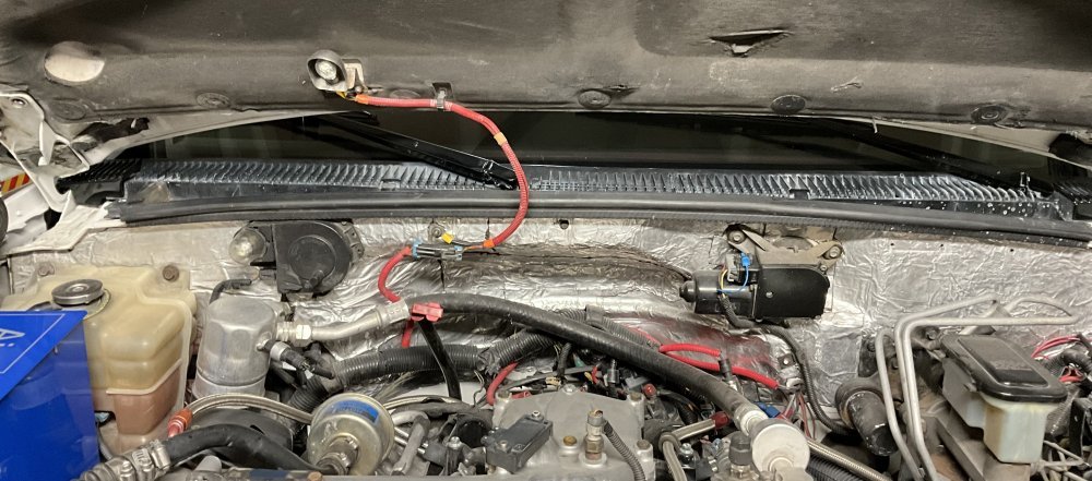

In 2011 I put on adhesive backed sound deadening material (RaaMat) only it has an aluminum finish vs. black. Thinner than Dynamat (sp) and denser. I first placed it inside against the firewall when I had the carpet out.
Later on I placed the same material inside the engine bay. In hindsight, it was a waste of money and time as there was no noticeable sound difference.
RaamAudio has been out of business for a few years now however, the product is holding up.
Only down side is aesthetically it looks unfinished. I did get some of their black padded heat resistant material to go over it but, with the engine in the hole, I’ve lost the agility and willingness to do the physical gymnastics to try to negotiate the task.

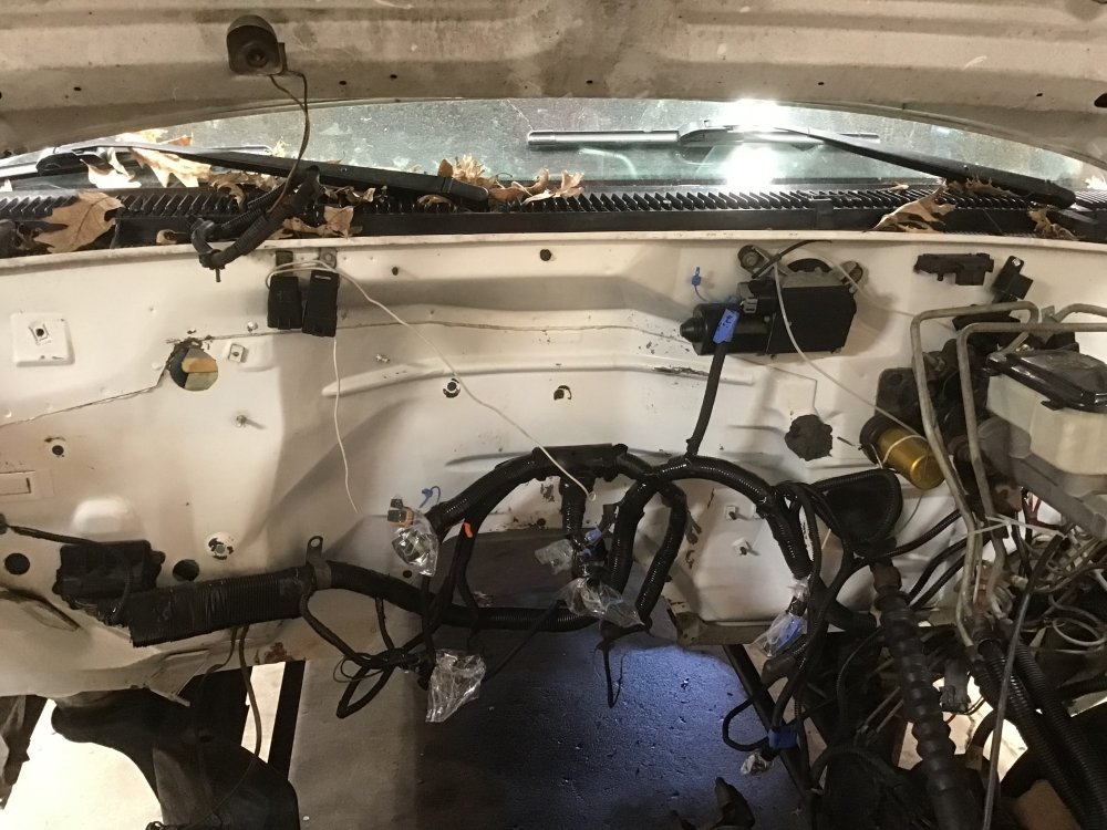

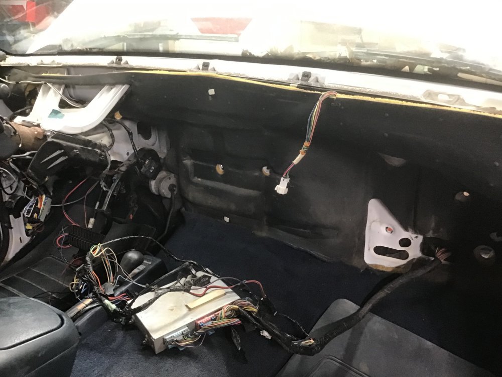

Thanks guys, the firewall inside the cab has the factory insulation still intact. I think if I do anything on the engine bay side it will be thin not like the factory stuff that was on there. I do need help sourcing the grey 2 1/2” thin foam tape that goes on top of the firewall inside the cab that the dash sets on. As you can see my dash is a mess. Pray for me to getting it to look half way decent 🙏🏻. I plan on using one of those after market glue on dash tops. Thanks again.IMG_0214.jpegThanks again.IMG_0213.jpeg

Heat help...not. Its a sound deadener, not insulation so, no help with keeping heat out. Once it gets warm, like any surface, it'll start transferring heat to the next surface. I think the real issue with heat inside the cab comes from the Heater Core setting right under the glove box circulating hot coolant anytime the engine is running unless the owner has installed a cut off valve.
