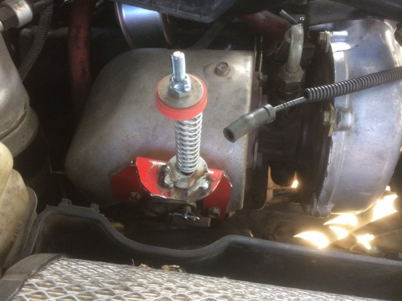

I do have a turbo master that I had built, it did drop the EGTs by a long ways, highest pulling a heavy boat over some mighty steep grades was 1000* and running 8 pounds of boost, it did increase fuel consumption by two miles to the gallon, measured over quite a few fillups. I got the terminals on the computer/vacuum cleand up real good and reverted back to that system. Have not had any runs without haulig a trailer behind to see where mileage is now at.

If your EGT's dropped after the install of your DIY turbo master, you need to turn up the IP pump up. The TM is to prevent the turbo fall off that the factory control has, it doesn't affect EGT that way. Your lower mileage is result of less efficiency, being in a lets say fuel starved condition, with the factory turbo less fuel versus boost, means less heat, thus lower EGT. Your leaving HP and torque on the table. In this case lower EGT isn't a good thing it shows your not getting what you could from it. If you turn up the pump your mileage will come back as well for the same reason. We all go through this when we first start tweeking.

You said 1000?!? That is barely awake on an idi diesel. Same with 8psi. 10-11psi on stock turbo all day long is fine.
