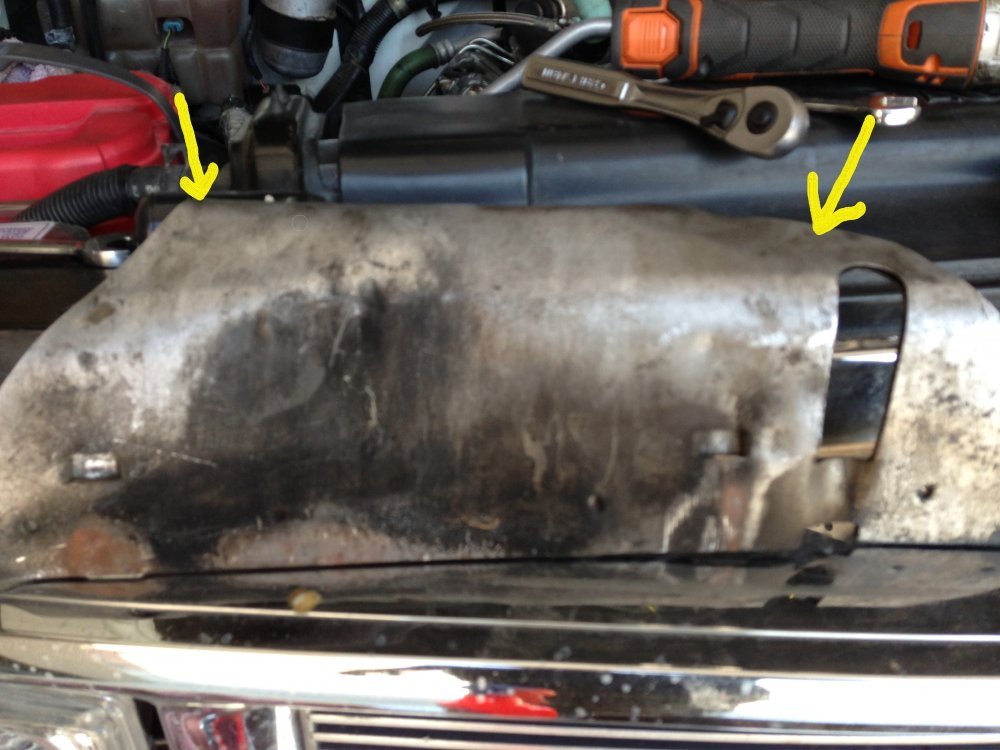

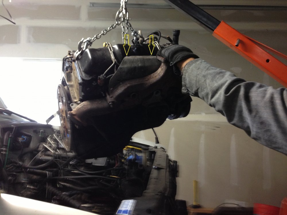

How do I get the heat sheilds off the right manifold? 97 K3500 6.5TD
I like to have the block heater plugged in for that stuff.With the engine cool….
From around the glow plugs? Remove glow plug wires carefully so as not to break the connectors.
Soak the nuts on the studs with a rust loosening / break free solution of choice.
Use a 13 mm socket and back the nuts off the studded exhaust manifold bolts.
From under the turbo, Back out the two Phillips head screws, grasp heat shield on both sides and pull upwards & out while wiggling back and forth to “walk” it out.

Have the nuts off but where are the two screws are they pointed down beside the valve cover? As far as I know they should be loose and they are not.With the engine cool….

Sorry I missed this question. Been working on another project.Have the nuts off but where are the two screws are they pointed down beside the valve cover? As far as I know they should be loose and they are not.
