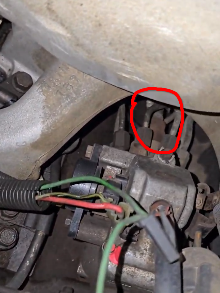

Don't be too quick to point the failure at the injection pump. go get a piece of clear hose and use it to replace the return hose. I paused your video to take a screenshot of the hose you need to be clear so you can see if you are getting air in the system.

Next once you have the clear hose in place of the hose I circled in the post above, then run the engine. look for bubbles flowing.

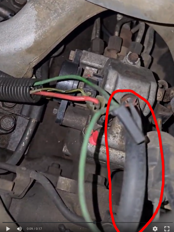

here is another screenshot of where the fuel comes into the IP at. if you look under the intake with a flashlight you will see a rubber hose connected where I have again circled in this photo.

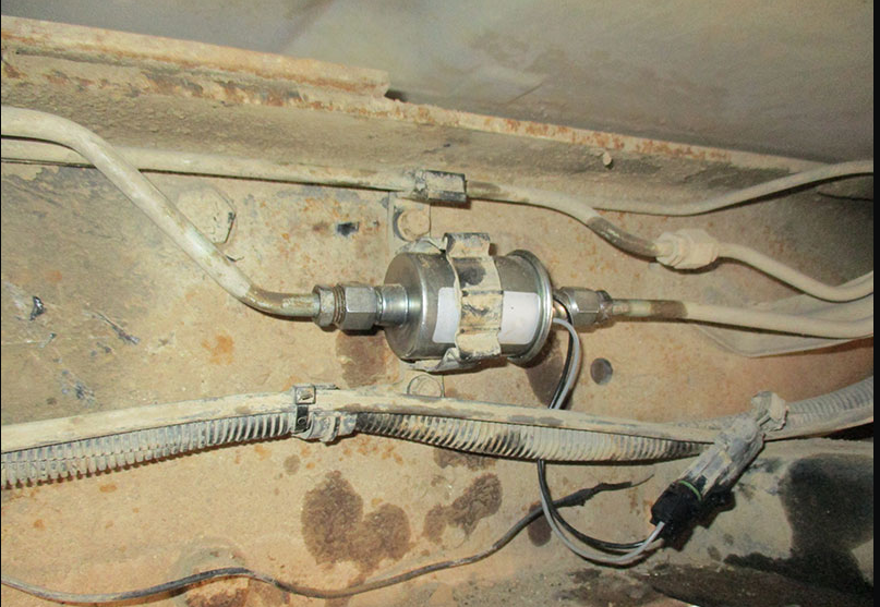

easy check to see if you have an electric lift pump.. look under the rig on the inside of the frame rail near the drivers door for this attached to the steel fuel lines. if there is nothing along the inside of the frame on the drivers side, then you have a mechanical lift pump on the engine.

I've been under the Blazer a few times and haven't seen anything like that, i found the mechanical one though, which my friend replaced last year (I was out of state when I lended him the truck, he did it on his own) so I suppose i can rule that out.

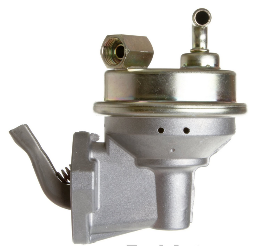

I looked up a lift pump for an 85 blazer 6.2 diesel and got a photo of what it looks like. this will be mounted on the engine block on the passenger side towards the front. there will also be another rubber hose from it to the steel line on the frame maybe 6-8 inches long. if he did replace it, that rubber hose can be the source of your issues with letting air in the lines.
others will chime in soon, but if the lift pump is there on the block, how does your turbo drain oil back into the pan? this lift pump is for a non-turbo style engine.
Yup, that's it, I remember now, he bought it off rock auto, it was made by Delphi

having this style mechanical lift pump also makes me think it can be the issue with the surging too. as it is pumped by the cam pushing on a rod which presses on the lever of the pump.
Others correct me if I am wrong here. if this pump is pulsing pressure up and down not keeping up the demand for the engine. the engine runs lower idle RPM as it's in-between the cam stroke on the pump causing the surging right after letting off the go pedal..

this makes me lean more towards you having a failing lift pump. as well as possibly needing to replace the rubber hose that feeds this pump too!
