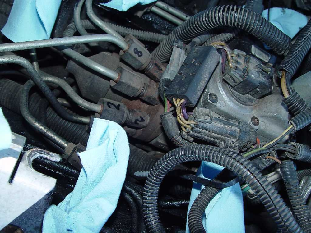

when you did the install, did you remove the noise filter that connects between the harness and the optic sensor on top of the IP. it's the large square connector on the top of the IP. the noise filter was something GM installed from factory, looks like a short harness adapter with a rectangular black box in the middle. those things are known to give issues. if you remove it from the harness and connect the harness straight into the IP it might help.
I'm sure someone here has a picture of it.
