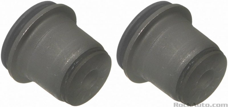

Please explain how the hell I'll get the rubber out of the metal without a welding torch?
Can you drill some of it out? Small drill and swiss cheese it so it can squeeze down easier??? piece of short pipe, washers, threaded rod long bolt / nuts and pull it out with a screw pulling action inverse of a press.
No way to get a drill in there....
