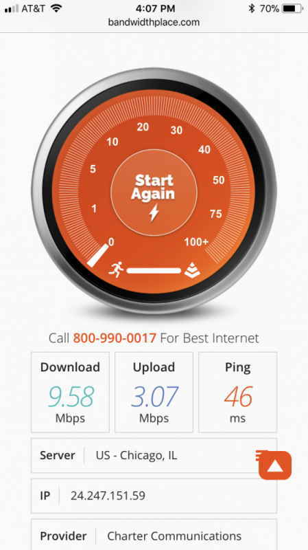

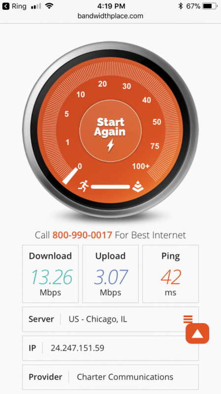

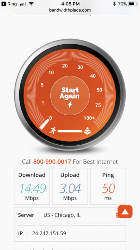

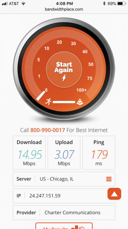

I ran wifi tests at multiple points and here are screen shots of the results:
Here is the speed 1’ from the wireless access point in the barn:
Here is the speed from the far interior wall of the barn about 40’ away:
Here is the speed outside the barn, above the man door, which is where I’ll be putting the other video camera. This is about 12’ away from the access point, but through the metal siding:
And here is the speed 1’ away from the router inside the house. As you can see, I lost no signal on that 250-300’ run to the barn:
