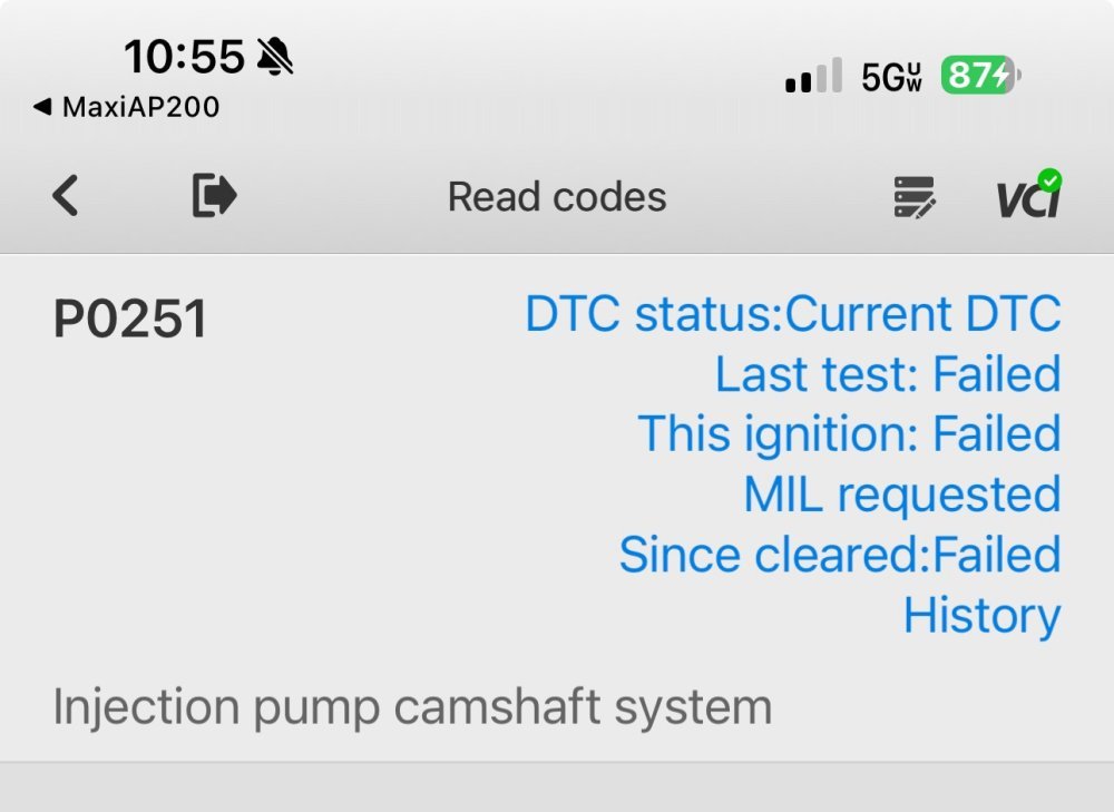

I emailed QS Tuning a few minutes ago so waiting for a reply from them.
Cleared the code and it pops right back up.
Engine falters when it does but then picks up and runs like nothing is the matter.
I have about five to ten miles to the next exit where I can turn around and head back home.
Anyone think it would be safe to continue on My trip from Miles City to Sheridan Wyoming ?
Is this with that brand new ip?
And no- long potentially danger trips are not advisable with a 251.

Got a reply back from John at QS.
In His reply He included this link.
It doesnt really match what My truck was doing.
Even with the SES lamp ignited acceleration was still good.
Then after getting to the rest area and clearing the code again, engine would crank a little longer like a possible optic sensor fault but then putting the shift lever into gear would kill the engine.
I just now sent Him another email asking if there is anything He would want me to attempt to do with this new pump before I install one of the used pumps.

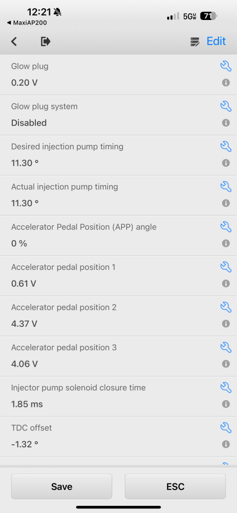

Have the used IP I just purchased from off the Hummer forum.
Truck runs and no leeeeks.
I have the heat shield and turbo bolted in position. Coolant is filled. No intake manifold as of yet. Was making sure this was going to fire and run first.
Warmed the engine to about 175*. Installed the temperature fooler device from QS tuning, I really like that little tool, thanks to @Paveltolz for mentioning that device in a thread or post You had submitted.
Although, be sure to sufficiently warm the engine to where it will not need the GPs to fire and run, at least with the tune I have, with a cooler engine mine wont run through the GP cycle. I found that out one morning after I had forgot that it was plugged into the sensor harness.
Anyhow. I been using a stick of angle steel between the rocker covers and thats a big aid in getting the IP close to the proper timing offset angle.
The passenger side of the back of the IP needs to be angled very slightly lower than the left side.
First startup after installing this used IP.
The engine fires right nice.
I am wondering though, without having the intake manifold bolted to the heads and the turbo hooked to it, even with the baro and intake temp wires connect, when revving the engine it seems to cut out and blow a lot of black smoke.
Is that normal when revving without having turbo pressure, even as slight as it is with turbo hooked to intake system ?
