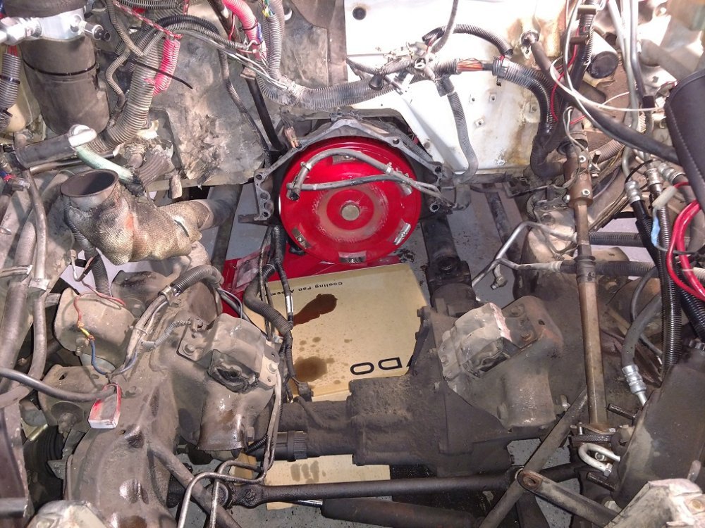

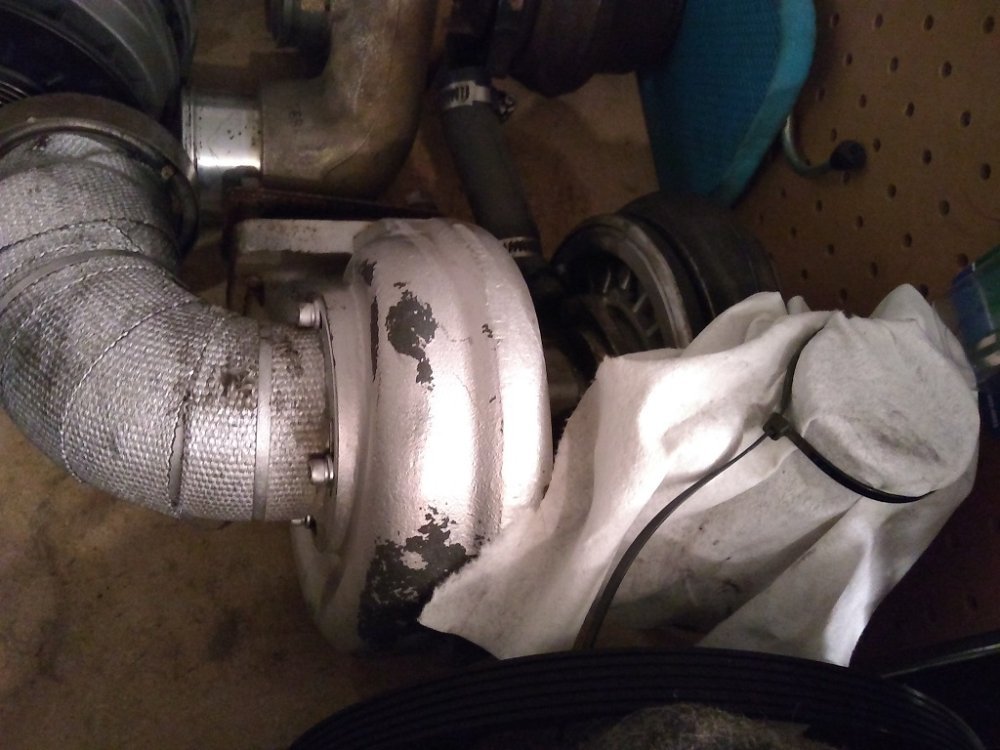

Header wrap it past the passenger floor pan. Header wrap on the manifolds. (Best done with manifolds removed.) Turbo blanket. All painted with the header wrap paint to reduce moisture and harden it in place.
When you ain't scared of 1550 EGT it helps things not melt in the area and the floor pan paint not burn to a different color...
I could lean on the turbo blanket after a run and not get burned.
Turbo and down pipe. Engine removed for clarity.

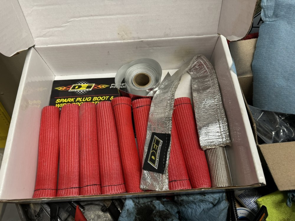

You can also source heat protection/retention material through DEI. Tape, Spark Plug Boots (thought I'd try protecting Glow Plug wires in the tubes on the passenger side...nope. Too Big), Sleeves and Header Wrap. There's more, to include Turbo Blankets which I had on my ATT but, not on the GM-8 I have now.
I used all the header wrap on the down pipe and cross-over pipe. The spark plug covers do fit over fuel and transmission lines where they are close to the manifolds. Same as the sleeve material. The 'tape' I used where header wrap began or ended and to hold the tube materials in place.
