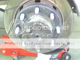

Is the seal on the end of the drive shaft? Here is a photo.
I found the seal on the back side of the roter. Since I am replacing the seal I should probably replace the bearings as well.
