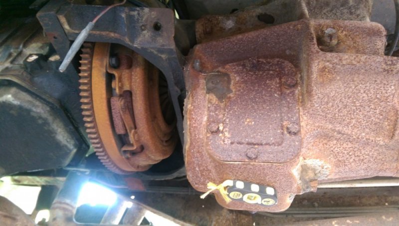

I was looking for the spec sheet of the 638 engine but could not find much info. I did however see a couple of pics of the engine.
I am always looking for alternative engines for the GMT400 series GM trucks, but, comparing the size of the engine in the pic. to the size of the starter, It appears the 638 would be much too big and much too heavy for the one ton pickups.
I believe the flywheel cover may also be the same as the bell housing adaptor, those items might also be interchangeable with adaptors from other Detroit engines.

I am sure you figured this out by now but i just saw this. Isn't that just a GM truck bell housing with the motor mounts on the rear? You might have to make a plate for the front but i would start with a late 90's truck flywheel cover. I am 90% sure it will bolt right on.
Your 638 Detroit is what was called a Package car repower package. Basically a crate diesel engine to convert gas UPS trucks with GM running gear to diesel. Everything from the flywheel back is 1999 era GMC. Clutch,pressure plate bellhousing and transmission.
