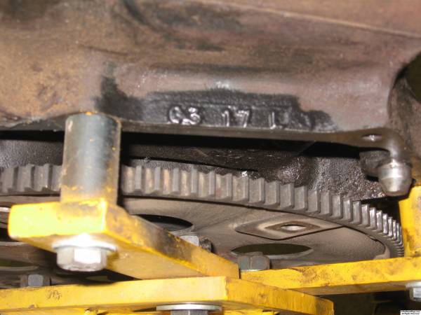

Date casting code on a GEP Optimizer should look like so:
That's 03-17-L
Mar 17 2004

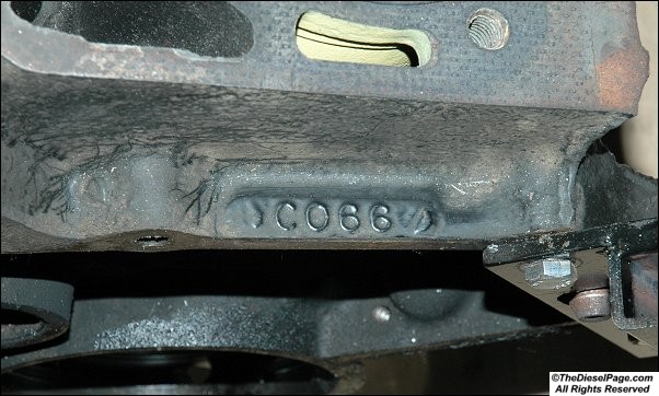

The older GM cast block codes look like so:
