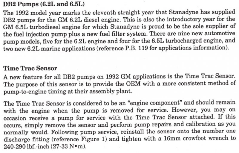

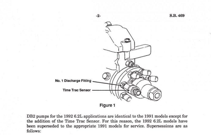

Would like to find out a little more on this obscure, but common, part. P/N 26605 Was it used outside the assembly plant for timing at all? It's buried on page 109 on Stanadyne's side.
