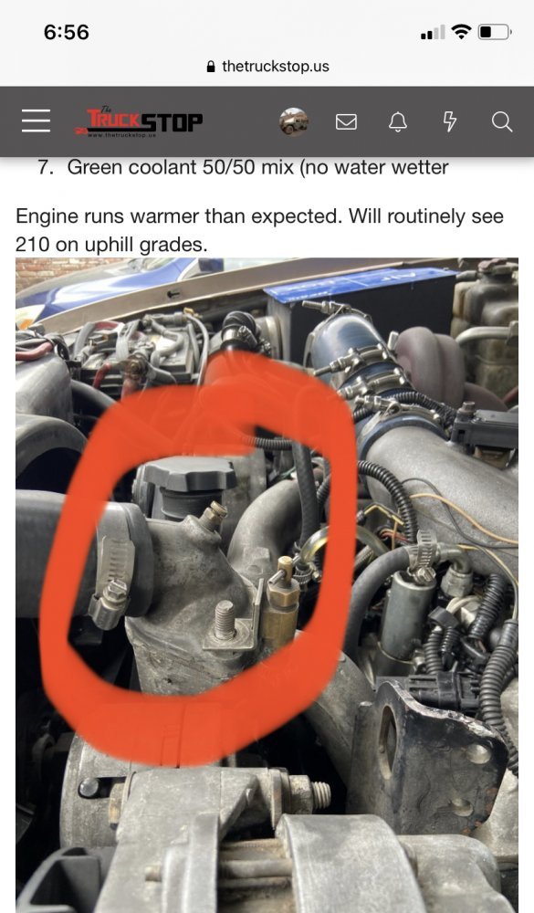

Mods on this cooling system include:
  1. Bosch HO water pump 2000 model year w/ spin on fan clutch hub
  2. Hayden fan clutch within the last 5K miles
  3. DMAX 9 blade fan
  4. New OEM style radiator
  5. AC Delco 190 T-Stat
  6. Single t-stat crossover
  7. Green coolant 50/50 mix (no water wetter
Engine runs warmer than expected. Will routinely see 210 on uphill grades.22A1EDF6-937F-4303-85B5-703C0C701D09.jpeg

We have GMTD Scantech on a laptop. I does run 5 F lower than the dash gauge. Need to do more testing.

Yes, Buddy 4-position tune. Pretty much stays on stock position where it is a dawg.
Do you have an egt on there where you can see if it is egt driven heat?
Yes
