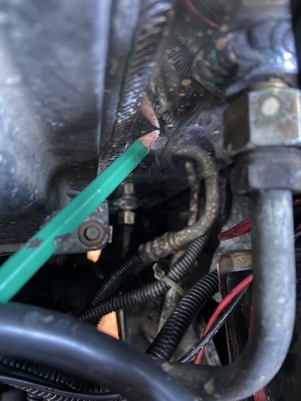

I have this stubborn coolant leak since installing the new Champion radiator last fall. It is on the passenger side and appears to be coming from the fitting from the upper hard line (pencil in picture pointing to the line of coolant leaking from the fitting):
It’s easier to see the coolant line when you flip the pic upside down. The leak shows when it’s been sitting, particularly in the current freezing cold weather.
What is this line for and how do I get it sealed up?
I will note that I have replaced all the rubber hoses over there as part of chasing this leak down.

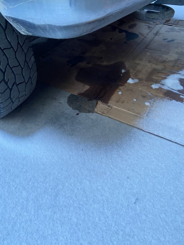

Pressurized from running it to operating temp, but really don't see the leak then. No to glow stuff and black light. Really have traced it to that fitting because there is a dribble trail from it. Last ran the truck on Sunday. Shoved a large piece of cardboard under the engine bay and today I noticed a large spot of coolant and the dribble from that fitting.
I'm gonna guess that line is your tranny cooler and the seapage is coming from the weld on the radiator. cold temps cause metal to shrink. it's possible the weld on the rad has a tiny pin hole that once warm it seals itself. I would think maybe pressure test it when cold. if it's past the warranty and the weld is the issue, the only fix would be to take the rad to a radiator shop or a good welder who can do aluminum and have them re-weld it

Would resetting that fitting with Teflon tape help? Or is it cracked?
imo resetting the fitting would only fix a tranny fluid leak at the threads. I would clean the area off real good and watch for a bead of coolant in that area if no access to a pressure tester, do you have a camera to put there on a close up and live record if for a while, when it begins to leak look for where the first coolant droplet forms at.
