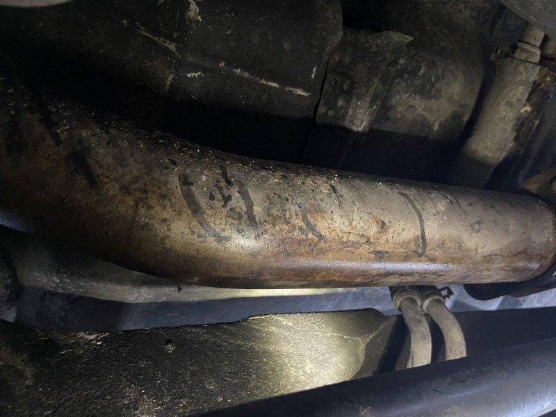

Have a coolant leak at the heater core pipes. Hoses were just replaced thinking they were the culprit, but the leak is still there dripping down onto the turbo down pipe and steaming off.

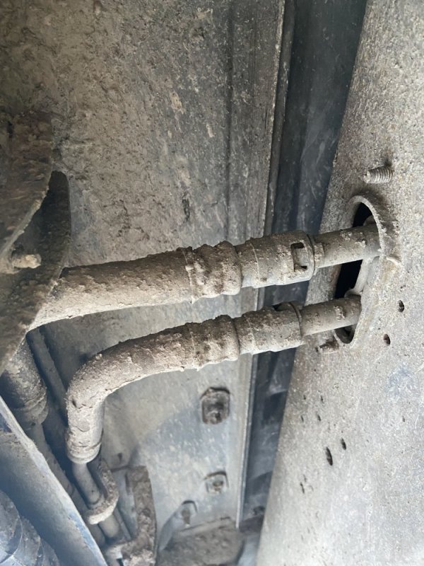

There is a few coolant connection (plastic quick connect) right under the passenger door?
Please check there.
It is also the lowest point of coolant flow.
So when it leaks, it leaks.
I had replaced the quick connect in mine with metal barb to barb.

Thanks, I will be checking those today.
I recently had a leak at one of those rear heater hose connectors under the passenger door, changed out the "o" rings and still leaked...it turned out to be the metal fitting itself was leaking at the crimp...so, I used a UV resistant self sealing tape and leak is now in check until I can get AN fittings to convert to braided hose there.

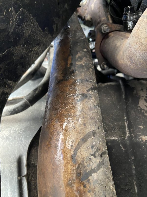

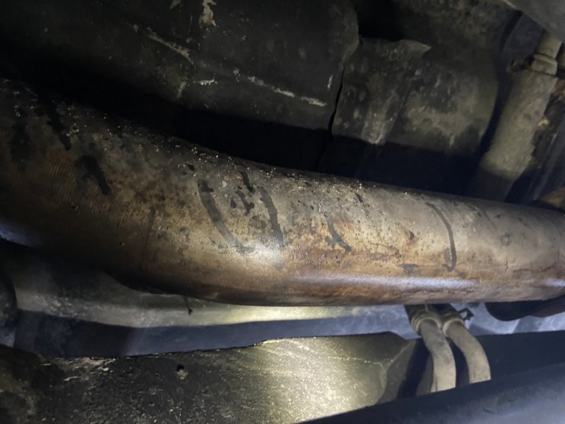

I checked underneath, including the rear heater hose connectors and they are not the problem:

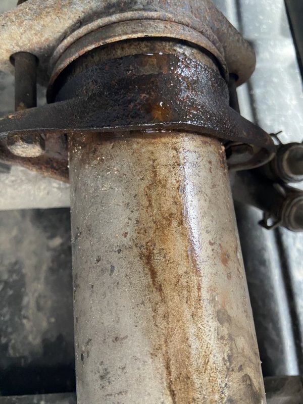

You can see the drip wetness starting much further forward on the Dow pipe:

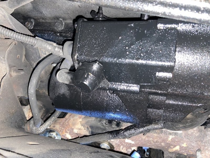

Also, here’s a pic of the oil leak area around the starter. The leak fan ends just in front of the starter and comes from above the starter:

When I was in there replacing the glow plugs and wire harness, I replaced the hoses to the heater core because the heat insulation was soaked with coolant at the bottom bends to the heater core. Unfortunately, this did not fix the leak. It could only be the heater core itself or the coolant reservoir, which are the only two coolant sources that could be dripping down onto that upper portion of the turbo down pipe.
The oil leak is perplexing. I initially thought it was comping from the CDR. It does seem to have slowed down after I replaced the hose connection the drain pipe from the ATT to the pipe going into the engine. I guess the only way to trace that down for sure is to pull everything off that side for a look. If I'm doing that, then I might as well replace injectors.

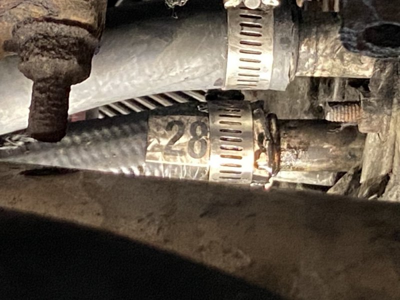

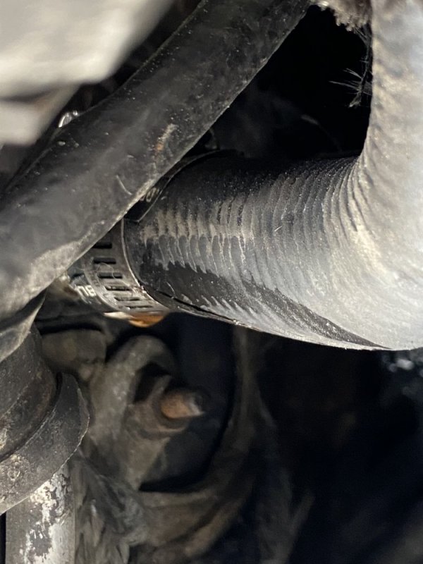

Pretty sure I found the leak. Outermost heater hose at the heater core. Although the clamp was tight, apparently not tight enough. See drip on 28 hose in first and third pics. Since it was dripping whenever I filled the coolant reservoir, regardless of running the engine, I extra tightened the clamp, wiped everything dry and filled the reservoir to test. No drip so far.
