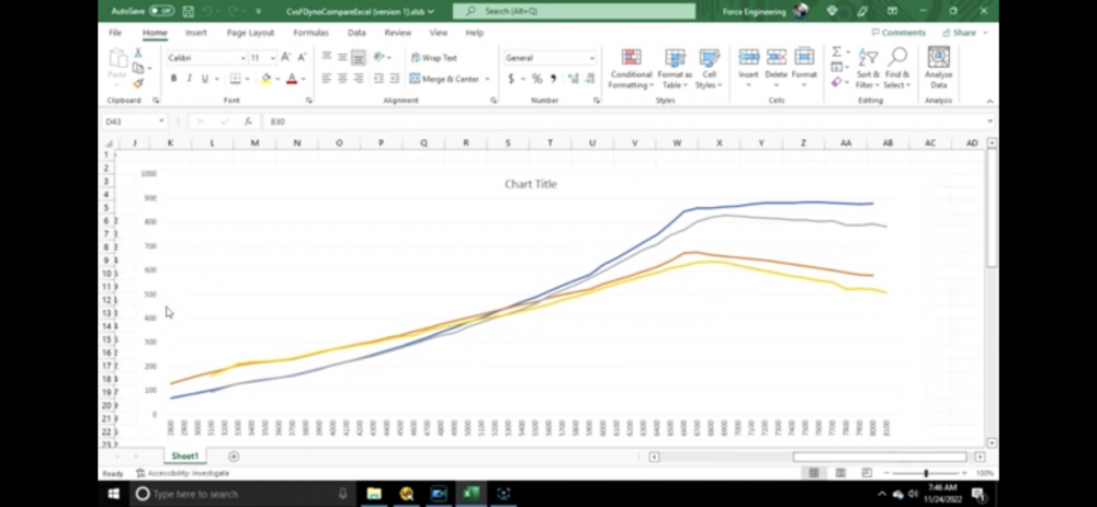

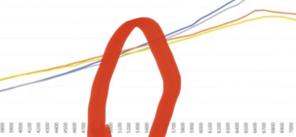

If you take a look at 9:50 you can follow up the chart to see that both dyno operators were not cheating the numbers by correction factor also.
5252 rpm is mathematically where hp and torque will always cross. If not the dyno operator is lying to you. This is regardless of engine or wheel dyno.

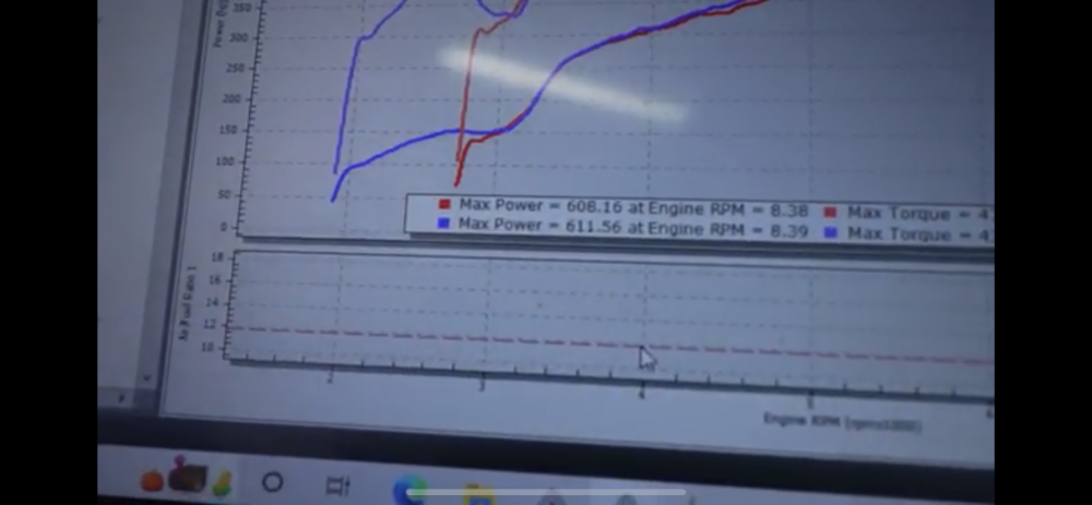

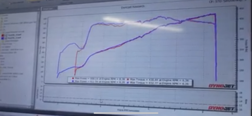

Like anything, don’t instantly shoot the dyno man if you catch him being off a little - but point it out and don’t accept improper factoring. Being off a few hundred rpm can be a legit mathematical mistake. But many shops do obvious huge ones that if the customers know what is up- they get busted quick. On Nov 15 a guy sent me and a couple others a YouTube video link and it took stoping the video a couple times to show how bad this guy was lying.
First pic, notice the far left column of graph is 1000 rpm, first column next to beginning of lines is 2,000 rpm, each line going up is another 1,000 rpm.
Now, looking at the second picture- you should see the hp & torque lines cross at 5252 rpm. But they don’t. They cross clear up at 7,300 rpm area. And in that video the guy talks about how they had to run the car in top gear to get the most power. And the fater the wheels spun the more hp and torque the car made. Nonsense.
Now back to the video Nate posted- look at the graph that has the two dynos being shown. Although because of the differences in how the dynos measure- both show the hp & torque cross at 5252 rpm. In other words these two dyno operators aren’t trying to lie by factor correcting.
