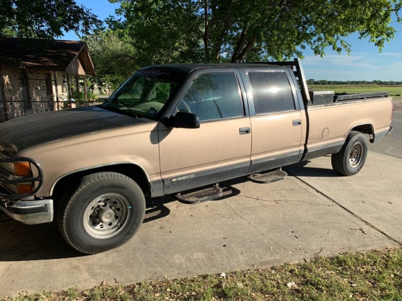

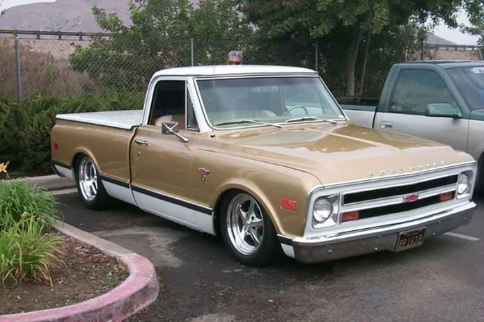

Hey guys, I have been pondering the idea of painting the top of my truck white to help combat the south Texas heat and lower the interior temps while parked in the sun. I've done a little research and seen others that had almost a 30 degree difference with white vs a black top on a vehicle. my question is what's it gonna look like! The original color was an all gold-ish beige top to bottom, but someone before me had painted the hood, lower panels, tailgate, and roof black. probably because the factory paint was faded or pealing. Ive attached a photo of my truck as it is now and what I was thinking of painting it to look like. although I was planning to do this one panel at a time in my spare time I have, which might turn into a 6 month project like everything else does! But for starters I wanted to at least do the roof only. is this gonna look like crap or really nice?
on the photo of the older Chevy, ignore the low rider look, bed cover, and the rims, just looking at the color scheme :)My Chevy.jpganniversary gold with white trim.jpg

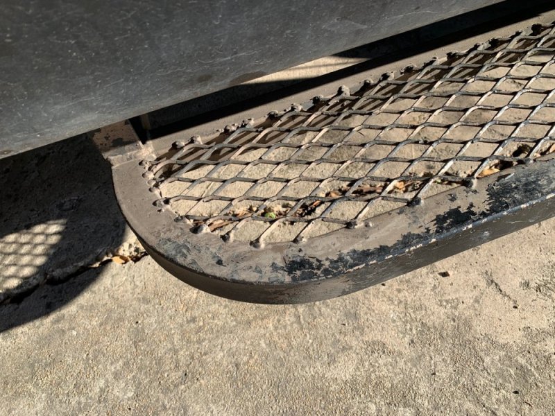

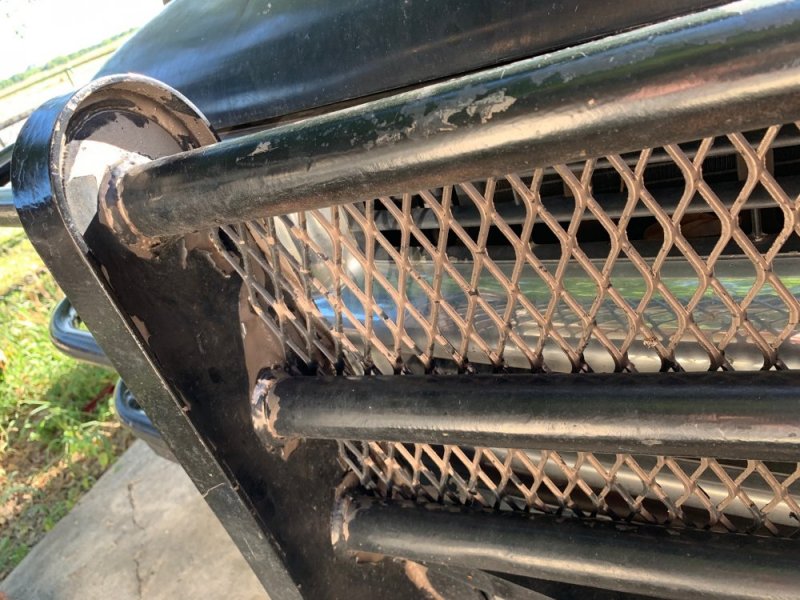

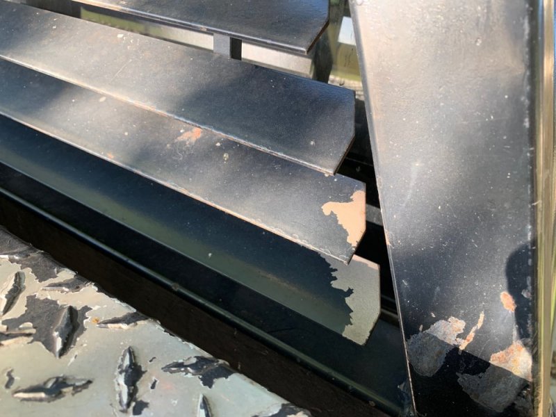

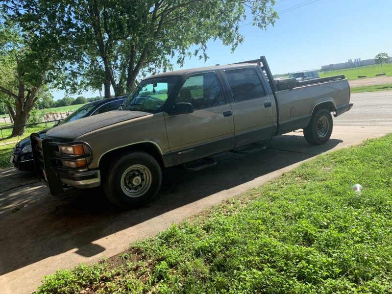

Here is a better close up of the truck now. Even the headache rack, grill guard and side steps have the same gold color paint on them, I can see it everywhere the black is chipped and pealing! At one time this truck must have really looked nice with all the accessories painted to match. I'm not sure if I should leave them black or not. Not really looking to make the truck look immaculate, just a back yard paint job done one piece at a time. After all, It is just my everyday driver / work truck!My Chevy-1.jpgGrill guard.jpgHeadache rack.jpgSide step.jpg

I personally really like the original light brown/gold color. That is the color my tahoe is...(maybe I am lazy but I like the fact that dirt does not really stand out on that color so I don't have to wash it as often. So if it was me I would repaint the hood and roof to the original color......................... But but that is just what floats my boat....not yours...
The white top will help, but to get the full effect you really need it all to be white. The doors being dark will heat up and transfer the heat inside same as the roof because as the top heats, the majority of the heat rises away only the convection heat from the roof affects the cabin. The doors will radiate laterally and upwards into the cabin.
Next the hood and fenders heating up tranfer the heat into the cabin. The more metal in the sun, the hotter the cab will get. A two door will get hot quicker because less air space for you to feel, but the over all temperature of a four door truck will get hotter.
Using sound proofing material in the roof and doors that is also rated thermally helps way more than the color. Basically think if you have a house with 4” insulation pained white, or 12” insulation painted black.
On the hide dirt- Most fleets go white for the two reasons of better mpg because cooler rig means less a/c and therefore less fuel burned, and as the rig gets slightly dirty, the appearance goes from bright white to off white. Darker colors show the dirt more UNLESS the color of the vehicle matches the dirt color in your area. Go to an outside car show car show and notice the gloss black shows the dust easier than red, and the white ones barely show any dust. Normally dirt is tan, so yes that color scheme hides the dirt, even from splashed puddles well. That gold color matches dirt very well in his area- notice the splash on the lower stripe and the hood, but not the mid section- yup cleaner look when it can’t be washed all the time, provided you don’t have the dark stripe right where the tires kick everything up on it.
Personally I am sick of that color because I see so much of it- used to love it - especially on these trucks. But That is the only color we get in the desert! Ever notice car commercials show rainy, forested areas in my part of the country and folks in predominantly wooded areas see commercials in the desert- the idea is change from what you have promoting the new car idea.

Personally, Myself, I would not paint the top white, that is a very nice paint scheme that's on there now. You might could remove the grill guard and side steps, etc; and get them bead or sand blasted and repaint those. I really like that paint that is called Hammered, no primer required and it goes on real nice and stays too. I have painted several items with the stuff and have not even had a rock chip, one item was the front of the hitch on My camper, it has been pulled quite a few miles, some gravel roads too and still no rock chips.
