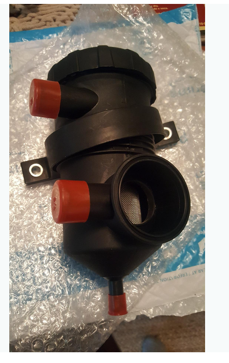

Guys, since I have found the need to install a catch can on my truck, I have been looking at the CKO knock offs on the jungle site and noticed something.

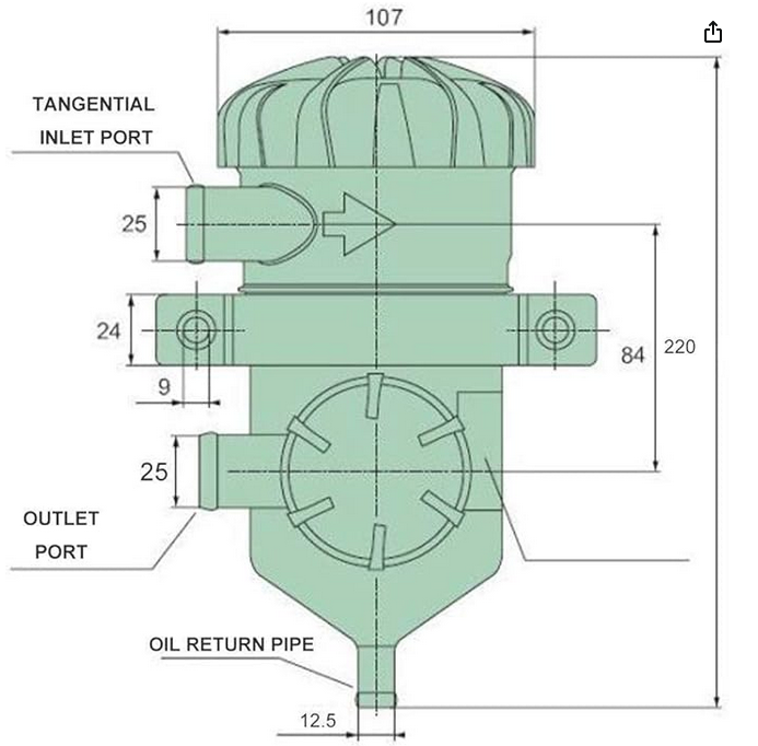

on the diagrams and photos, each one shows the outlet at the lower end of the housing. this got me to start thinking about gravity and the oil collecting at the lower end of the catch can how easily the oil can be sucked into the intake when the can doesn't have very much oil in it.
I'm not going to link the item but if you go on Amazon dot com and search this item number B08FMN2B63 or B07HKBRZ2K you will get one of the knock off provent 200's.

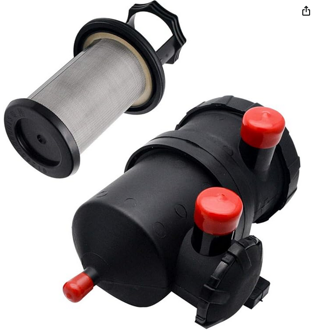

These all come with a stainless mesh filter but can be replaced with the "real" provent 200 filter. Look at the diagram where the inlet and the outlet is along with some photos I pulled from the ad and from user reviews. take note of the outlet location and how there is nothing stopping the oil from flowing into the top and going back into the intake from the lower connection.
I'm not exactly sure how the valve in the lower connection is supposed to work, but user comments are saying that it's free flowing in both directions. Tell me if I am wrong but I think that it would be better to reverse the connections so that the inlet is at the bottom and the outlet at the top that would connect to the turbo intake tube. This way the crankcase vapor would have to enter from the bottom and go through the outside of the filter and up through the center to the connection at the top.

Here is something that shows the real filter does fit but needs a slight modification. the guy uses a cut section of some clear rubber tubing to make a spacer on the o-ring. also take note of the copper tubing that he fitted into the hose ports to give it some extra rigidity even though he does not mention it in the video.
Nice.
I see the KO 200s in fleabay for about $40.00.
I guess the paper/cloth filter is the one to use.
A light smear of silicone dielectric grease and the expanded O ring filter would pop right in without force.
for a re-usable filter, the thought occurred to me to take the mesh screen filter from the knock off one and wrap it a few times with some TP or cheese cloth. something cheap and disposable though the wifey might not like me very much stealing her cheese cloth or cutting her panty hose for a filter HAHA.
He said in the video something like - does the other filter work better, who knows…
He obviously was just then trying to install it for the first time. Everyone that used the real filter and tried the stainless steel mesh ones noticed they almost completely quit working.
In one video He was talking about bypassing the over pressurization valve. Probably not the smartest idea. If the system quits flowing properly it will build pressure and open up there to vent pressure rather than blowing out gaskets.
Mounting the catch can so the line from the valve cover, or oil fill tube if oil slinger guard is installed is better, then having the 1” line being a long hose and at same height or higher than the supply outlet- all helps. Getting the vacuum side line short as possible to have a higher vacuum level From the turbo is a good thing.
Improperly installed drain line will destroy the functionality of the unit.
Mounting the can near the hot engine or exhaust is not helpful also. You want the hoses and can all to be as cold as possible.

Btw- do not just modify something into a filter. It isn’t a filter to clean. It is a coalescent device named as a filter so people just have a familiar term. It isn’t filtering anything.
