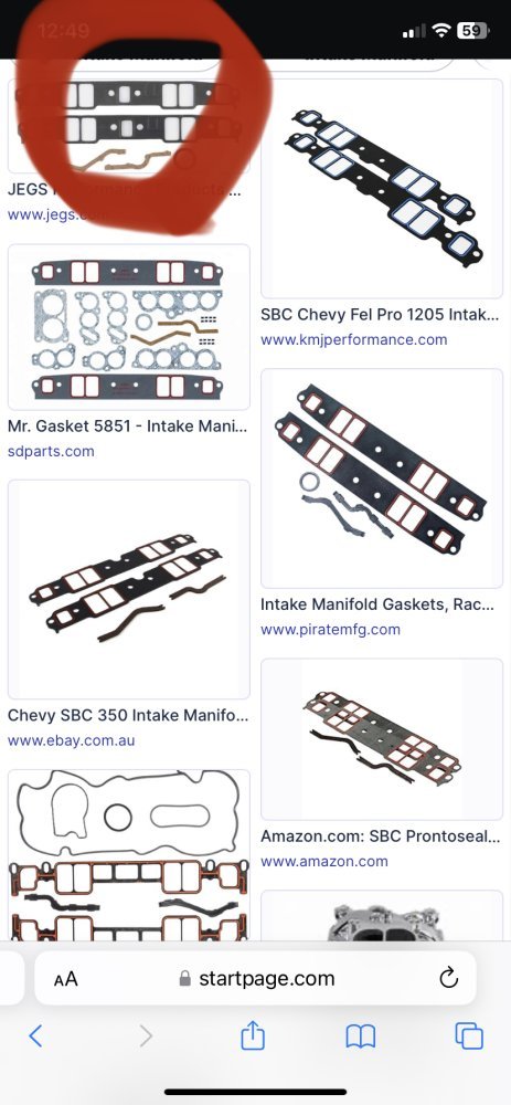

Google search “350 small block, Chevy intake, manifold gasket” and clicked picture.
See the circled gasket has the hole for stock use? Notice no holes in the others? No one wants the egr heating it usually. People add a cable for choke.

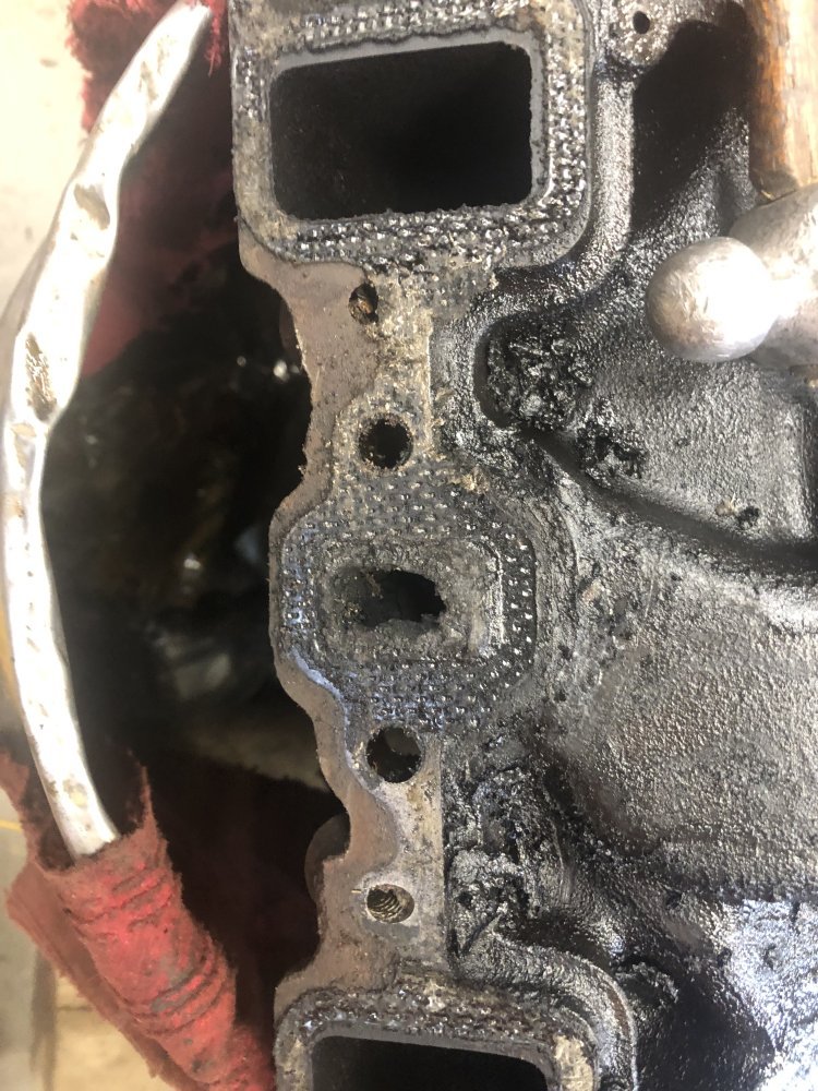

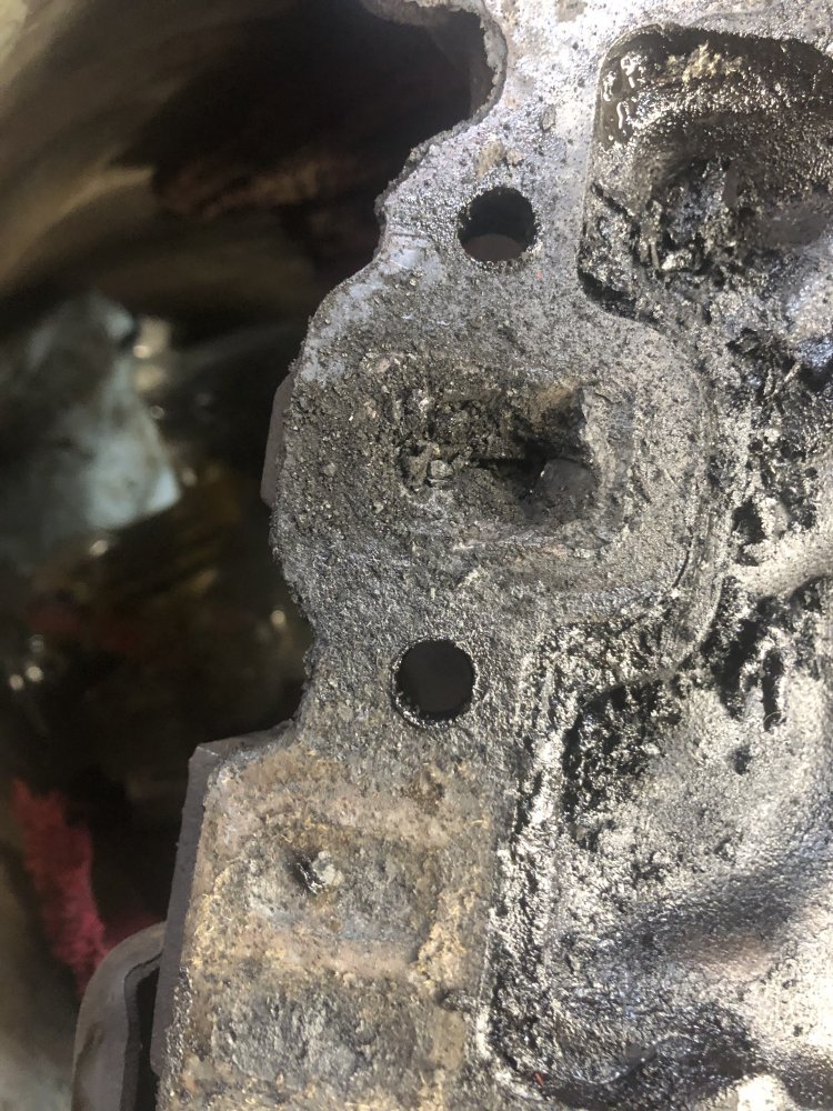

I started to chisel and hammer the carbon away.
Yeah, manifold was plugged.
The intake manifold gaskets had a block off plate on one side. That plate had a hole in the middle of it.
Should a plate with a hole in it be added back onto the gasket. There are two in the set.
Yeah, I started hammering that Snapon screwdriver, pounding that carbon out of them ports, then,? Remembered to get a couple of pics. 🤷‍♂️😹😹😹

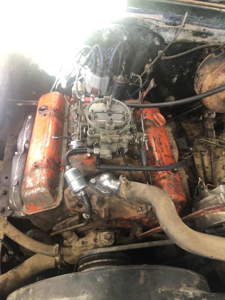

I see the location of your oil fill. you can swap the valve covers left to right and have the oil fill in the front on the passenger side and have the pcv grommet in the front left as that is if you want. pull the carb or bag cover it and give the engine a craigslist rebuild (rattle can paint job) after a good power washing too if ya want to spiffy thing up under the power barn LOL
I like old crusty, scraped and bad paint. IDK about Nick though. He might find that intriguing.
Maybe I should surprize Him. Get some of that Rustoleum color shift paint and do a number on it. 😹😹❤️
I will pass along the info to Nick in case He does want to freshen it some.
